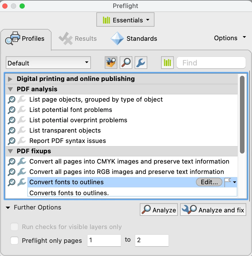

Not sure which program you are checkin, but if the only issue is that the printer needs the fonts outlined then you can do it within Acrobat Pro if you have that. Go to Edit>Preflight and then see below. The alternative is to create outlines within Illustrator itself, but personally, I like to keep my AI files fully editable but of course you can always keep a copy.
Hope this is what you mean, if not please try and explain more fully.
