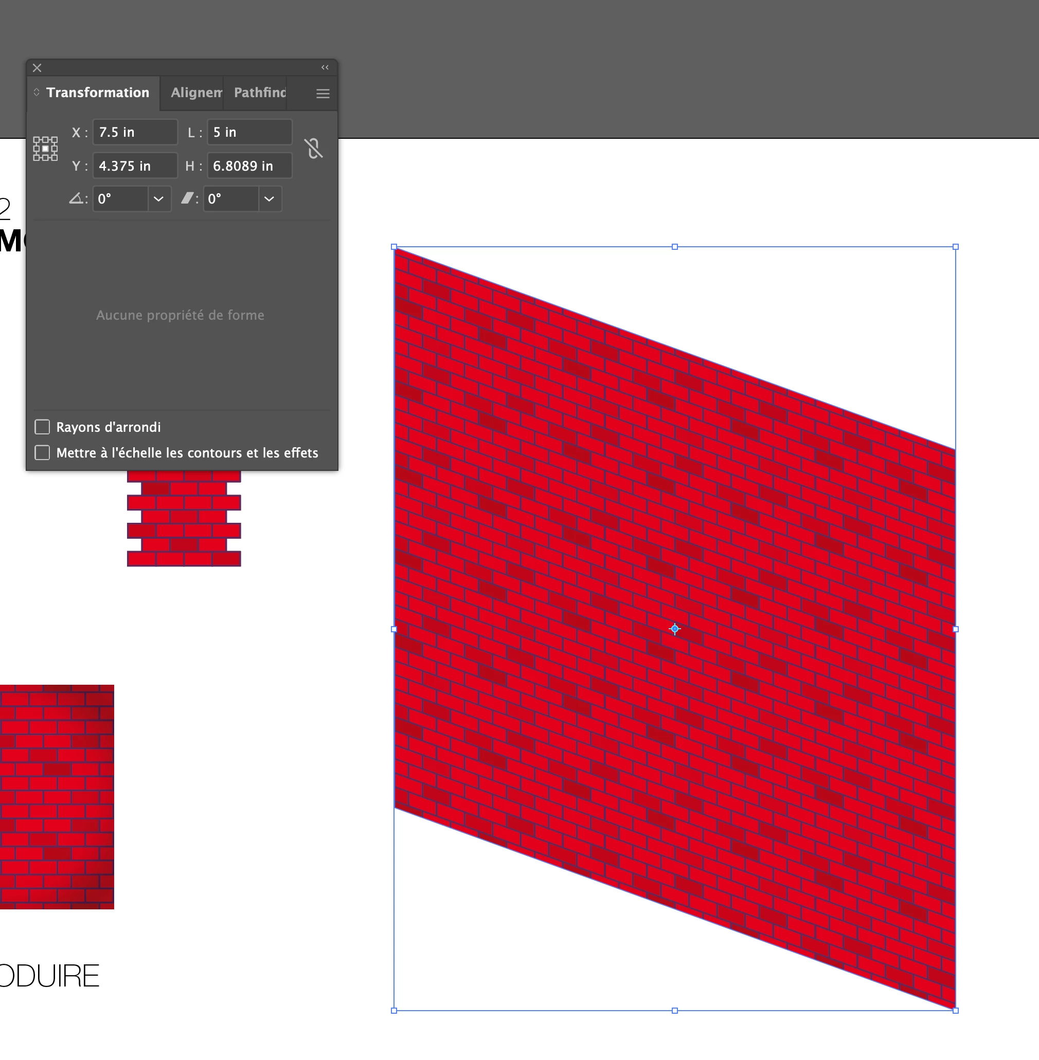

Hi!
Is there a way to do a vertical shear using the Transformation panel?
All I seem to be able to do is perform horizontal shears:
Thank you!
Chris.

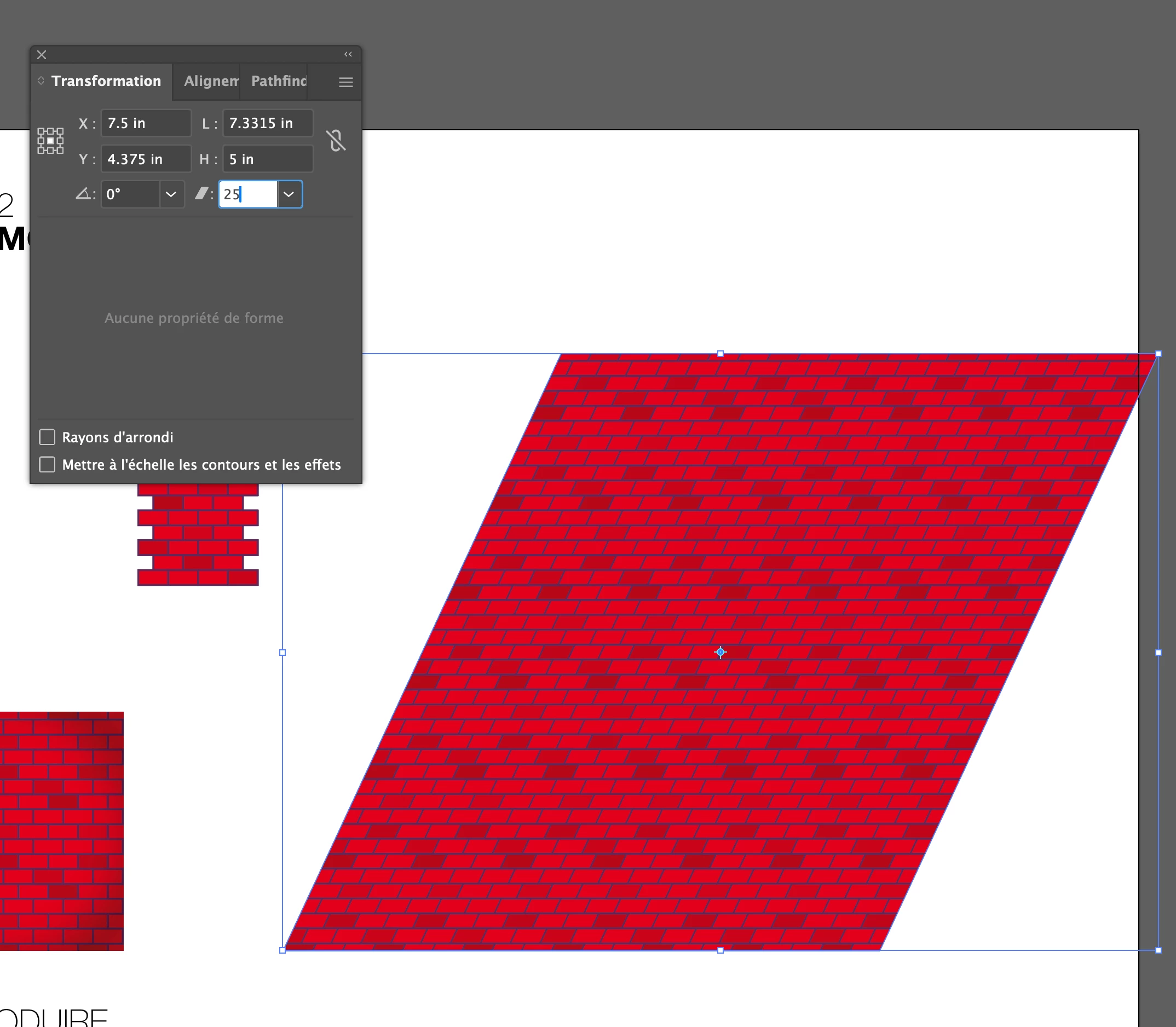

CarlosCanto
January 25, 2024
yes, it's possible
1. rotate your object 90 degrees (button next to shear)
2. shear 30 degrees horizontally
3. rotate -90 back to it's original position
Syntax_One
January 25, 2024
Very long and counterproductive workaround, but it works! Thanks! 🤗 Hopefully Adobe will fix this nonsense in the near future. Have a nice one! Rock on!

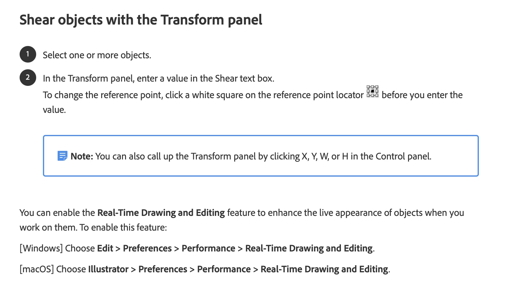

Jacob Bugge
January 24, 2024
Syntyax 1,
You ought to be able to choose your shear axis; you can read on under Shear here,
https://helpx.adobe.com/illustrator/using/scaling-shearing-distorting-objects.html

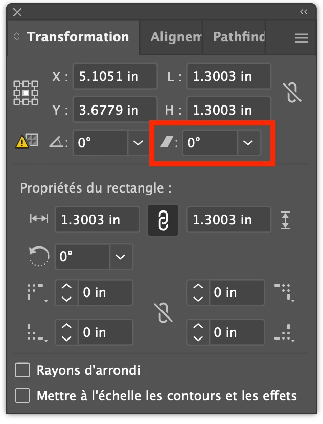

Jacob Bugge
January 25, 2024
Syntax 1,
Have you tried setting the angle to 90 degrees, to the left, at the exclamation mark in your screenshot?

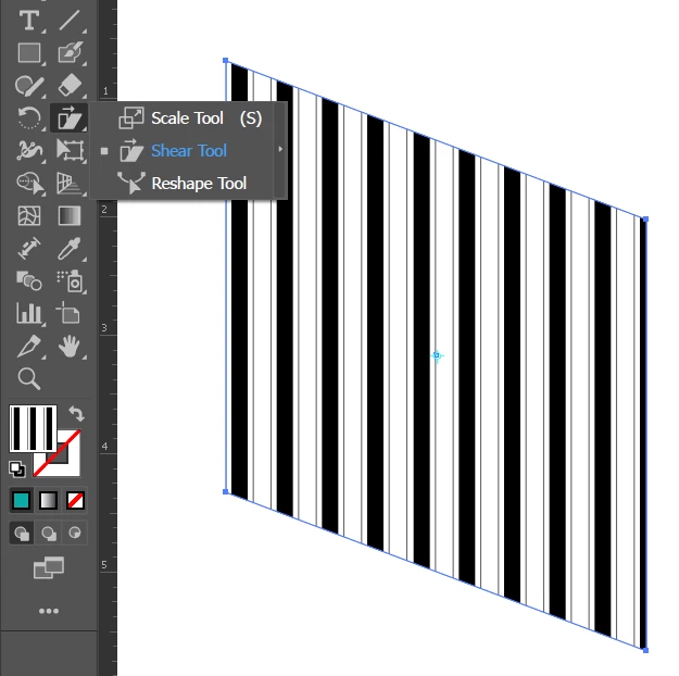

January 23, 2024
yes, grab the Shear Tool and pull the selected object up or down
Syntax_One
January 24, 2024
Thank you! But is there a way to do a vertical shear using the Transformation panel?
