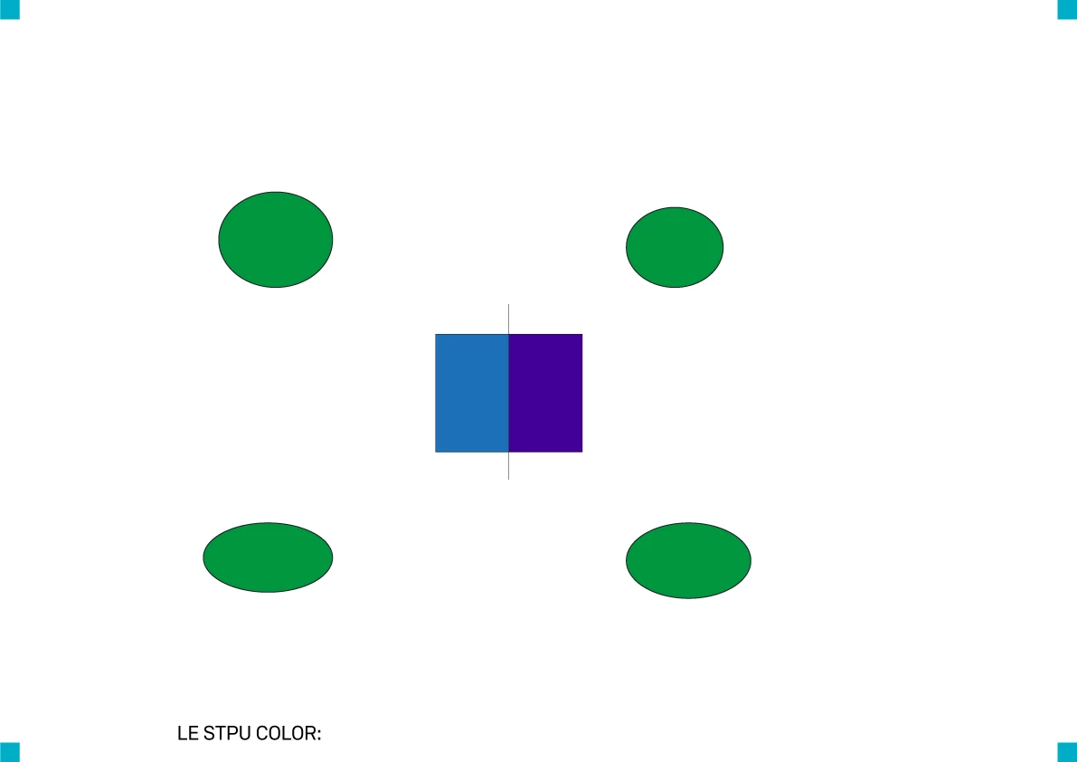

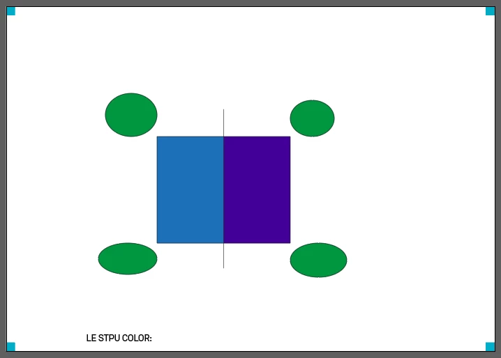

I am making a script that takes objects from visible layers and scales them on a temporary layer 'temp' and then exports those scaled and grouped objects as a png.
There is only one problem, one object is a live paint and it is causing some problems. Everything looks perfect until You take a look at the exported png. The live paint object remains in original size in the export even though in illustrator it is scaled correctly with other objects.
But when I run the script secont time withouth the scale function it exports as it shoulds. Do you Guys have any idea?

Thank you! I tired for 2 days to solve it with different workarounds but apparently just this one line was all i needed.
Thank you again!
