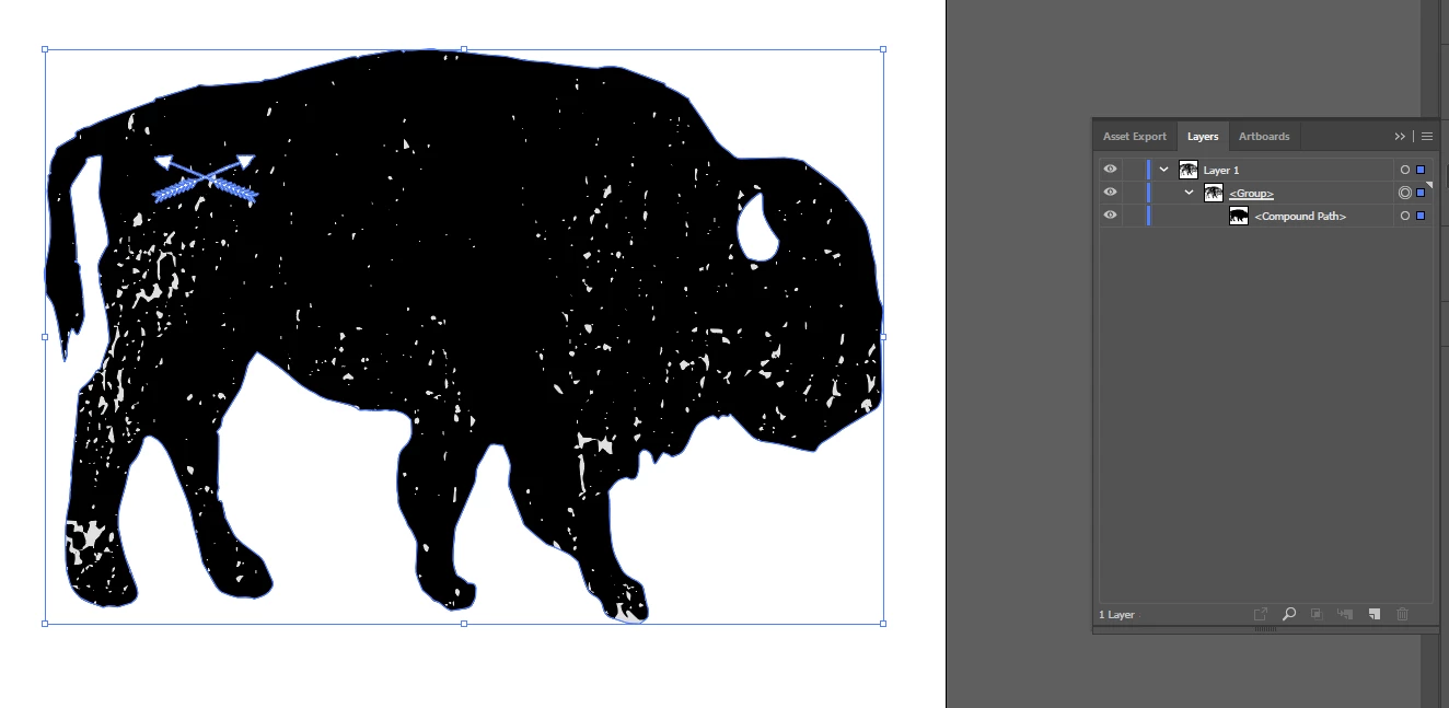

I've recently had a client submit an artwork that I can't seem to reverse-engineer. While I don't necessarily need to, this dang thing is keeping me up at night because I truly don't understand how it works.
So when first opening up the artwork it looks like this:

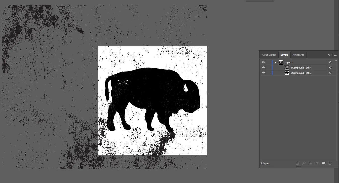

It looks fairly normal, but upon further inspection it gets quite interesting. If I UNGROUP the compound path, it gives me two separate compound paths:
Strange right? If I try to simply select both of these, and hit "create compound path" it does nothing. The closest I can get it to the initial compound path is if I select both, and hit "minus front", but it doesn't give me a single compound path as a result.

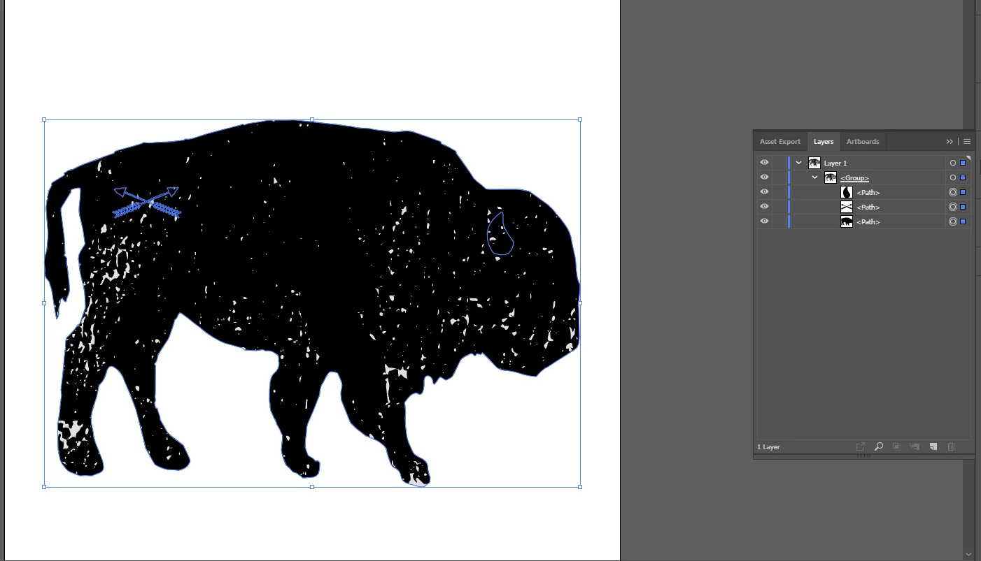

I also have tried RELEASING the compound path, instead of ungrouping, and it gives me three objects (the texture seems to disappear):

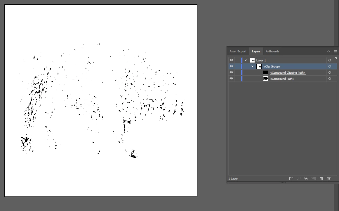

Forgive me for being slightly unfamiliar with clipping masks, but when I select both compound paths and do Object > Clipping Path > Make  I get this as a result:
What steps would I need to take with the ungrouped compound paths to achieve initial compound path they had? (sorry to have to ask for a spoonfed answer, I'll be reading up on clipping masks all day after this.)
