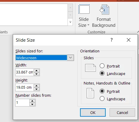

How is the PowerPoint slide set up? At certain pixel dimensions? Or something relative or adaptive?
Mylenium
October 27, 2022
That doesn't appear to be standard HD, but rather 2560 x 1440. You may need to adjust your artboard sizes. And keep in mind that PPT assumes 150 PPI as the default.

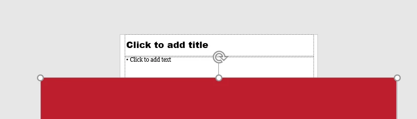

October 27, 2022
Thanks but doesn't work, see the result below I get
