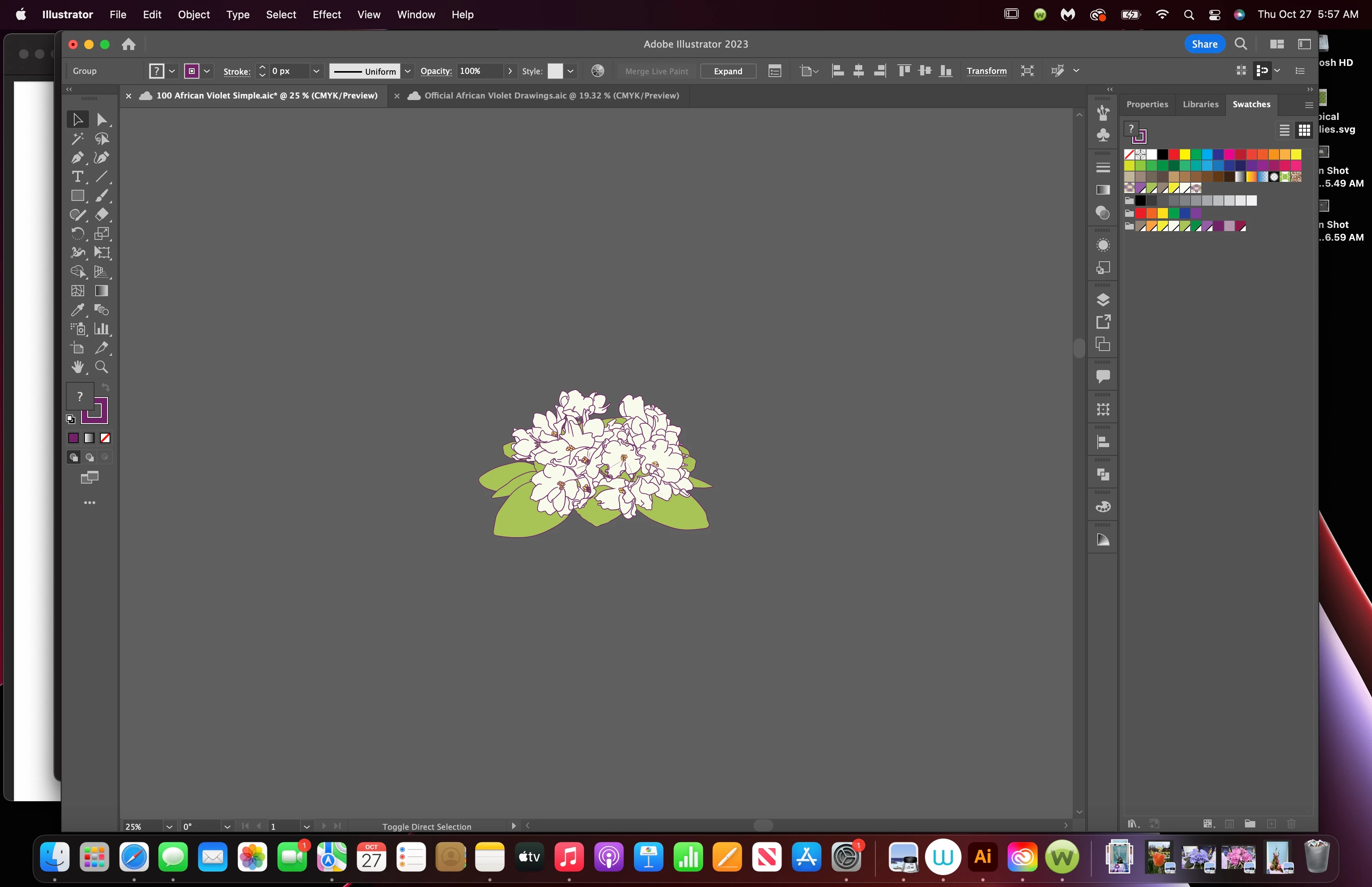

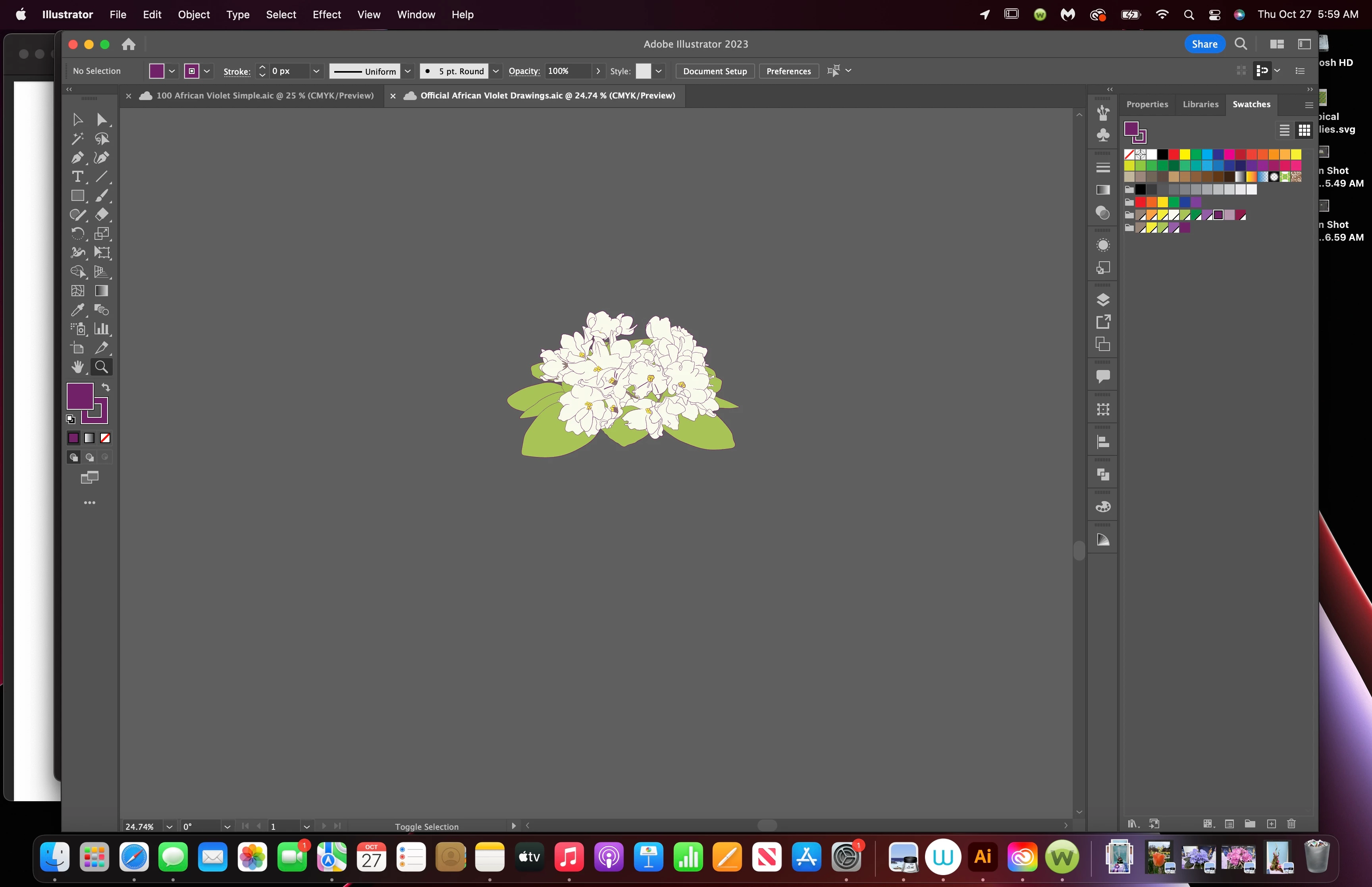

Yes, The one that appears with thicker lines is the copy and pasted one. The drawing was made with the blob brush and the paint bucket was used to color it in. What's happening?
Monika Gause
October 27, 2022
Please show a zoomed in version. It would be nice if you could embed your screenshots in your post and just screenshot what's necessary.
Please do also show the outline view as well as the objects inside the layers panel.
