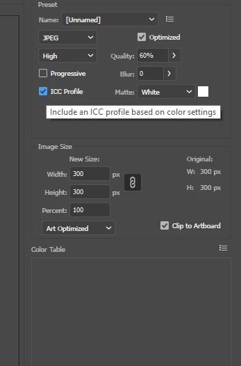

PNG and JPEG etc are saved in RGB colour format as they are classified as "Web formats".
(I believe it is possible to save a JPEG as CMYK but this is not a standard setting, and there is very little reason to use a JPEG CMYK other than potential? file size)
I would recommend using/making an only RGB file and use only sRGB colours to match against the CMYK version.
The only format that might benefit from CMYK is the PDF/EPS but this format can be set up to accept either RGB or CMYK only - i.e. your final output has to be one or the other not both.
Additionally you could try embedding the colour profile in the PNG/JPEG etc when exporting from Illustrator:
