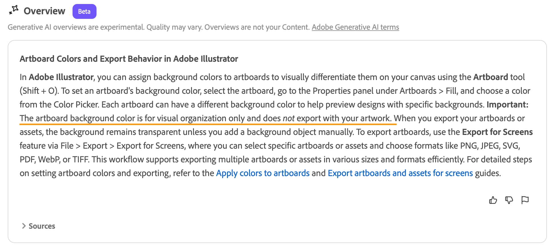

When using a colored artboard, the artboard then exports as an object and imports as an object into another .ai file.  The artboard color is described as just being a visible GUI change, but it is acting as an object.  SEE VIDEO.

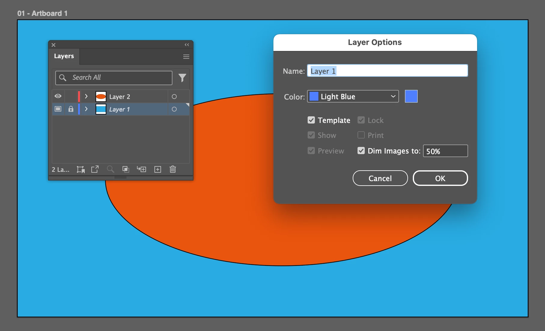

    It is acting as a background. If you want to have a color in the background, but not have it visible when placing, you can do the paper color trick as Dave mentioned or create a layer with a filled color shape and make it a template layer.

    Thanks Dave!  Illustrator’s help threw me off because it says it shouldn’t export the artboard which was happening.  Thanks for the help!
