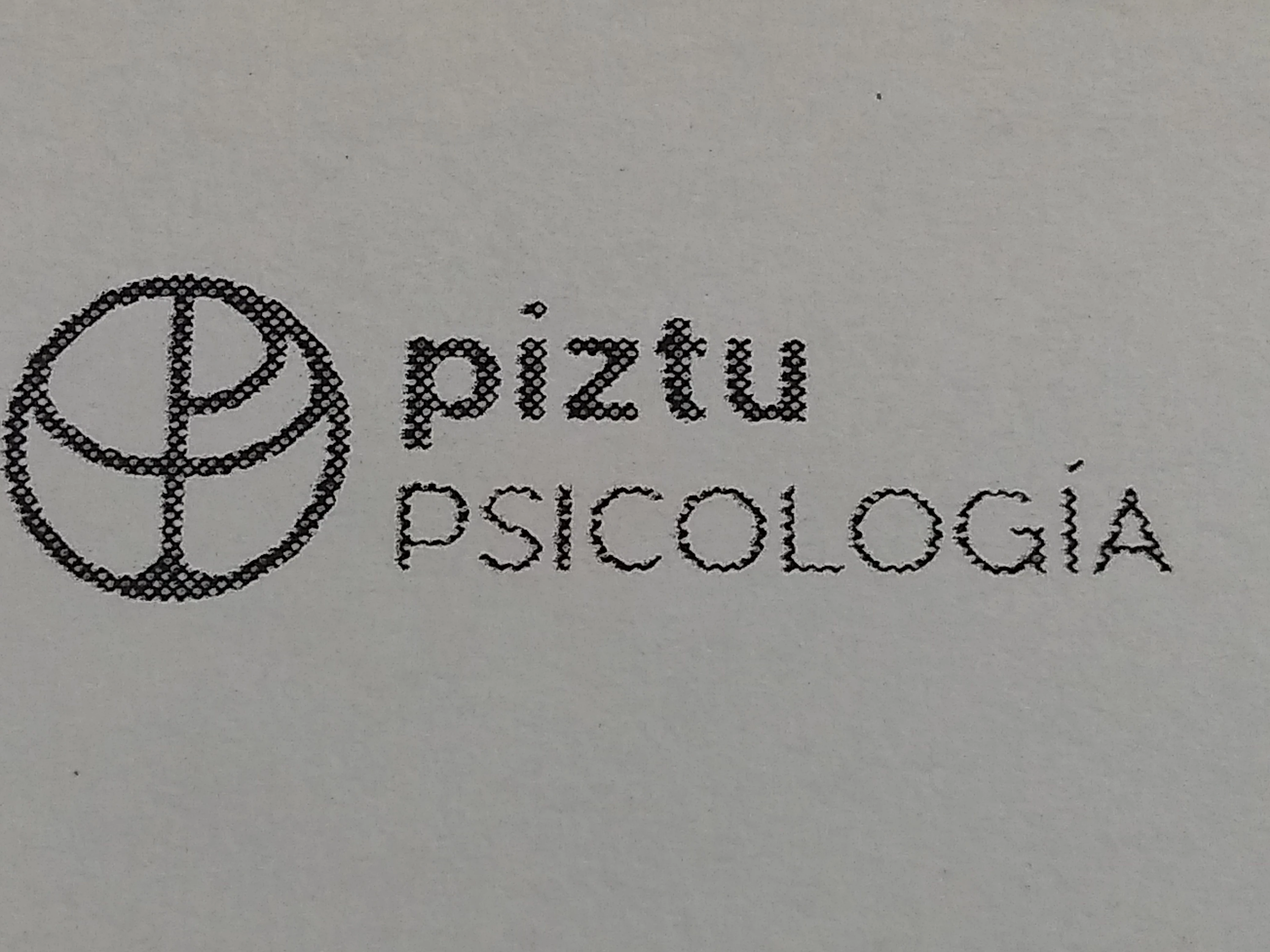

My text in path when printing does not do it well, and the first "I" looks thicker than the "I" with tilde
Why it happens? thanks

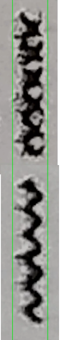

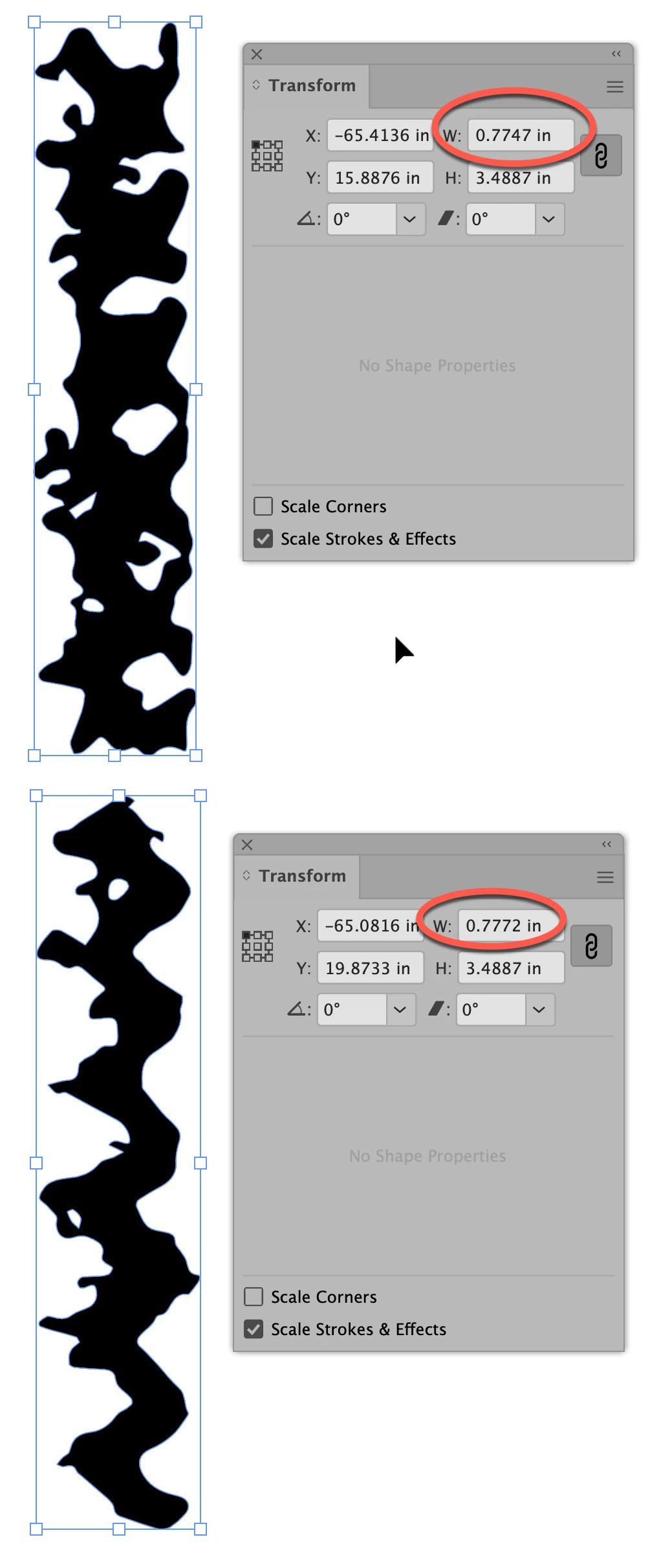

The operative words here are "looks thicker". It's an illusion: The portion of the crosshatching that shows on the two letters is different, and the X part looks thicker than the zigzag part, but it is not:
Peter

Did someone apply a width scale factor to the Í?

This is how it comes out, I read that it is recommended not to trace the texts and embed the font, but I have had some bad experience
October 7, 2020
Link pdf
The options of the pdf "high quality printing" do not change anything
