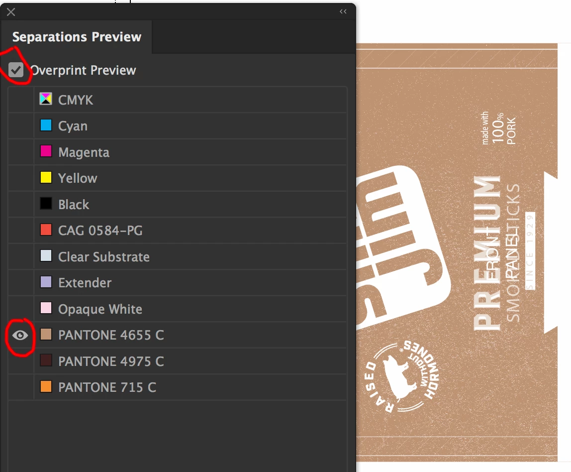

Mike_Gondek10189183
October 19, 2018
Window >> Separations Preview (Check overprint to enable)
Do you see any other colors, besides CMYK? Those colors arento CMYK, but  in color model Spot, and you need to change to CMYK. You may have missed one, or for example you may have placed an image that has a spot color channel assigned in Photoshop. To help you find what elements are in the post color option click on the visibility eyeball to solo (show only) that color as in my example below showing only PMS 4655 C,
Option click on the solo'ed eyeball to show all again.
