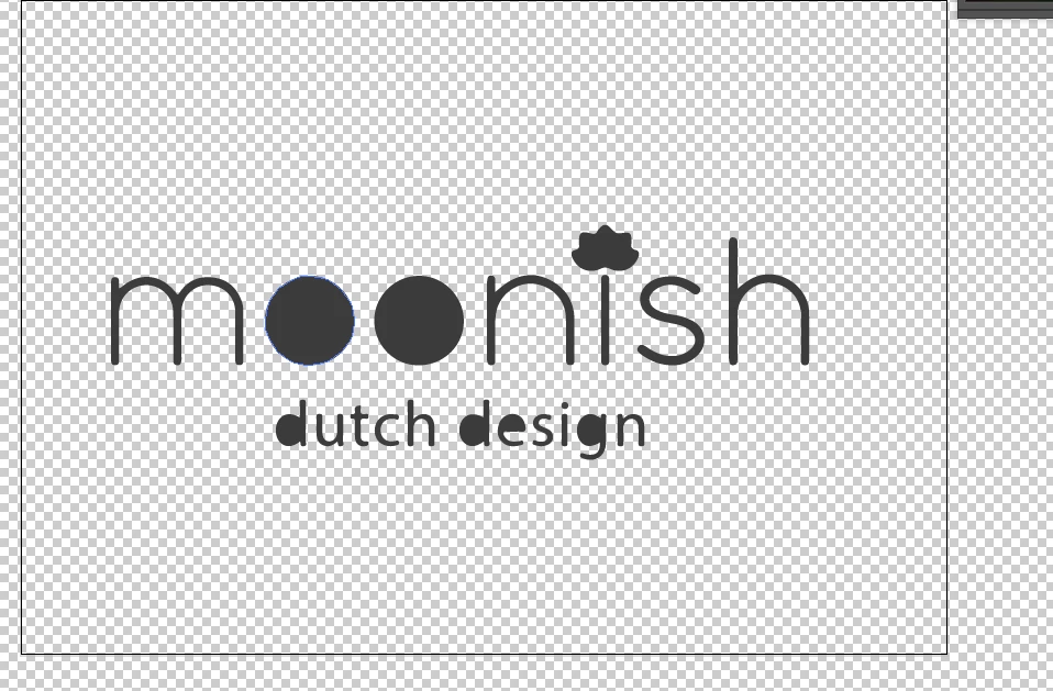

WHat exactly are doing there step by step and what exactly do you expect this to look?
Did you create the shapes using Image Trace in CS6?
January 8, 2017
Yes, the shape is created by Image trace. I expect it to look like the it is right now, just with a transparent background…
So exactly like photo below, but without the white background. ( and I want to be able to regroup the object and move the object above the I )
What I do step by step:
1. I open a new Doc.
2. I add a photo
3. I expand it ( image tracing: high fidelity photo / view tracing result)
4. I take my magic wand and click on the white background, it selects all the white surrounding the object
5. I click delete and it takes away the white, but also fills the closed spaces like the o,e en the object above the i
Just tried to clear the paths, it said was not needed…
Thanks for responding and for your help!
macpawel
macpawelCorrect answer
January 8, 2017
You can remove white background during Live Trace - it's the easiest method.
Just go to Live Trace Panel Options and then open Advanced settings (lower part of this panel) and go to Ignore White settings. Just select it and thats all. In this case your background will be transparent
Pawel
