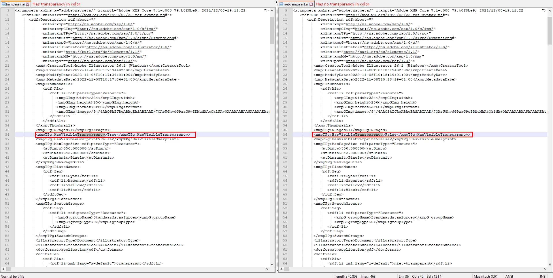

I'm working on a project and i'm not really experienced with this. I want to make a plugin where users can upload only .eps files. But there's a catch...
The user can only upload .eps files and these files can not have transparant color in it. I thought of something to search for specific transparancy value and if they are there the plugin won't accept the file. But actually i don't know anything at al about .eps files. I hope somebody can teach me the basics or help me find the terms i have to look for in the file to not accept it.

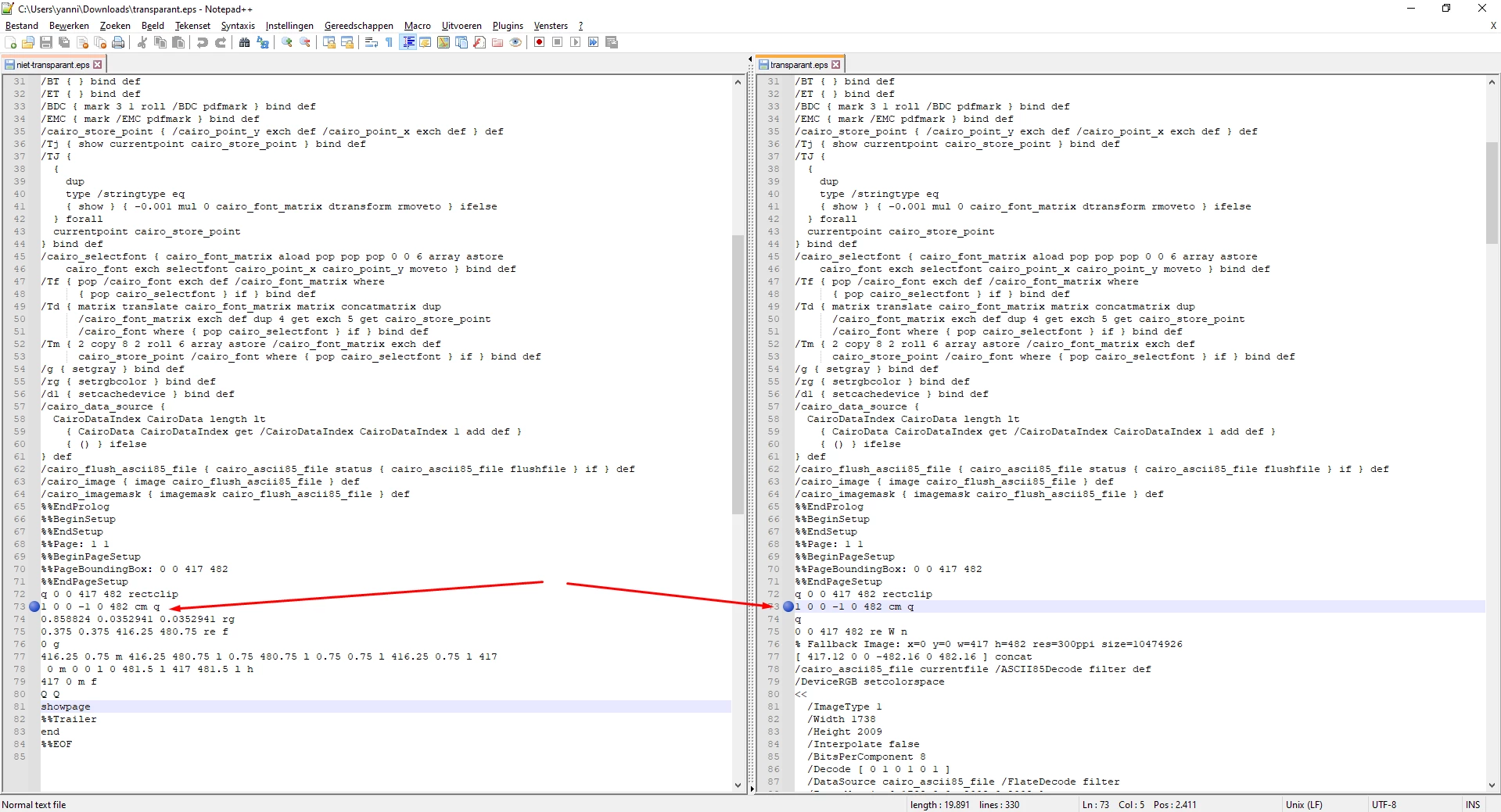

I have made 2 .eps files one file contains a transparent color the other doesn't. I've noticed that the file which does not is much shorter. Also the file with transparency in the color has a fall back image and is much longer. Is this because of the transparency color or are there other things. I will ad the screenshot of the difference between the files.
Correct answer Ton Frederiks
EPS files cannot contain transparency. What you see is probably the Illustrator part of the file.

Is there a way to check if the .ai or .pdf has transparancy in the colors without acrobat preflight profile? We are trying to create a custom plugin for in wordpress with php and some libaries. I've made 2 exact same files while one has transperncy in the color and the other one doesn't. I can see the one with transparency has something like transparency true. Is this the same when you use more objects in the vector? Is this the way to detect transparency in the source file? Thanks a lot for all the help and thinking 🙂

Hi @brilliant_Mountain5D09, how are you generating the .eps files? If you are exporting .eps from Illustrator, it may be rasterizing section(s) of the page due to transparent elements which are not compatible with the .eps format (as @Ton Frederiks noted). That would explain why the file size is larger—because it contains the raster(s). I think it may be challenging to programmatically determine if the .eps code (ie. PostScript language code) has signs of being converted in this way unless you familiarize yourself with all the things that Illustrator does to "flatten" the file, and identify those things as tell-tales in the postscript. But what if one of your users gives you postscript generated with a different app, not Illustrator—it may have different tell-tales. Maybe someone has a quick fix, but I think it'll be a hard job you have set yourself.

Ton Frederiks
Ton FrederiksCommunity ExpertCorrect answer
October 25, 2022
November 1, 2022
So is if there's a fallback image like on second file, it's not a correct .eps file to use for print work?
Ton Frederiks
November 1, 2022
The Illustrator part that is saved with some .eps files is meant to be used by Illustrator when the file is reopened.
This part is not the .eps part, which will lose many editing capabilities.
