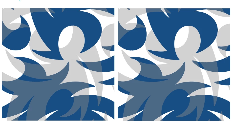

it sounds like what would happen if you had a white filled path under the top filled path. If you have two identical filled paths right on top of each other, even if you copied, and pasted on front, it will often show one pixel of the path underneath at a low zoom, even if there is no way you'd see it. if you started with a white rectangle to be the background on your pattern swatch, instead make the background a rectangle with no fill or stroke.
also, if you are using transparency, that can cause the appearance of a line, as it does in the the following pattern swatch which you can find preloaded in your swatch libraries from AI.
This one is called Jive, and as you can see on the left, there is a darker grey line running through the grey shape horizontally near the middle.
The one on the right doesn't have a line because I dragged the swatch definition from the swatch panel into the workspace, selected it and then selected "Flatten Transparency" from the object menu. After that, I dragged the selection back into the swatch panel like I was making a new swatch, which it was automatically called "Jive 1".
You might say, "what use is it to have these swatches if they're always displaying wrong?" well in the end, you just have to flatten the transparency of your work before you are totally finished with it. if you are making something which needs to be transparent in the end, you can also expand the artwork from the object menu, then isolate the group of the the pattern, then select each color in the pattern, go to the select menu and click "select same fill and stroke", (unless they were overlapping with a different color inbetween) and then go to the pathfinder menu and click "Unite".
with this pattern, you'd select the grey, which is 40% opacity, select same fill and stroke, click unite, it would probably disappear, then you'd edit cut it, then select the blue select same fill and stroke, then paste in front (command F) which would cause it to reappear, albeit outside of the desired lines, then do the same with the blue, but instead of pasting in front, paste it behind all of the grey shapes, then find the original outline that the pattern was supposed to fill, cut it, then select all of the grey and blue shapes, hopefully they are still part of a group, paste the outline in front (command F) then with all selected, go to object > make clipping mask, which would make all of the parts of the pattern outside of the line not visible.
it seems like a lot of work, but once you do it a few times, and memorize the keyboard shortcuts it will only take a few seconds. you can also make an action to do a lot of this work for you.
