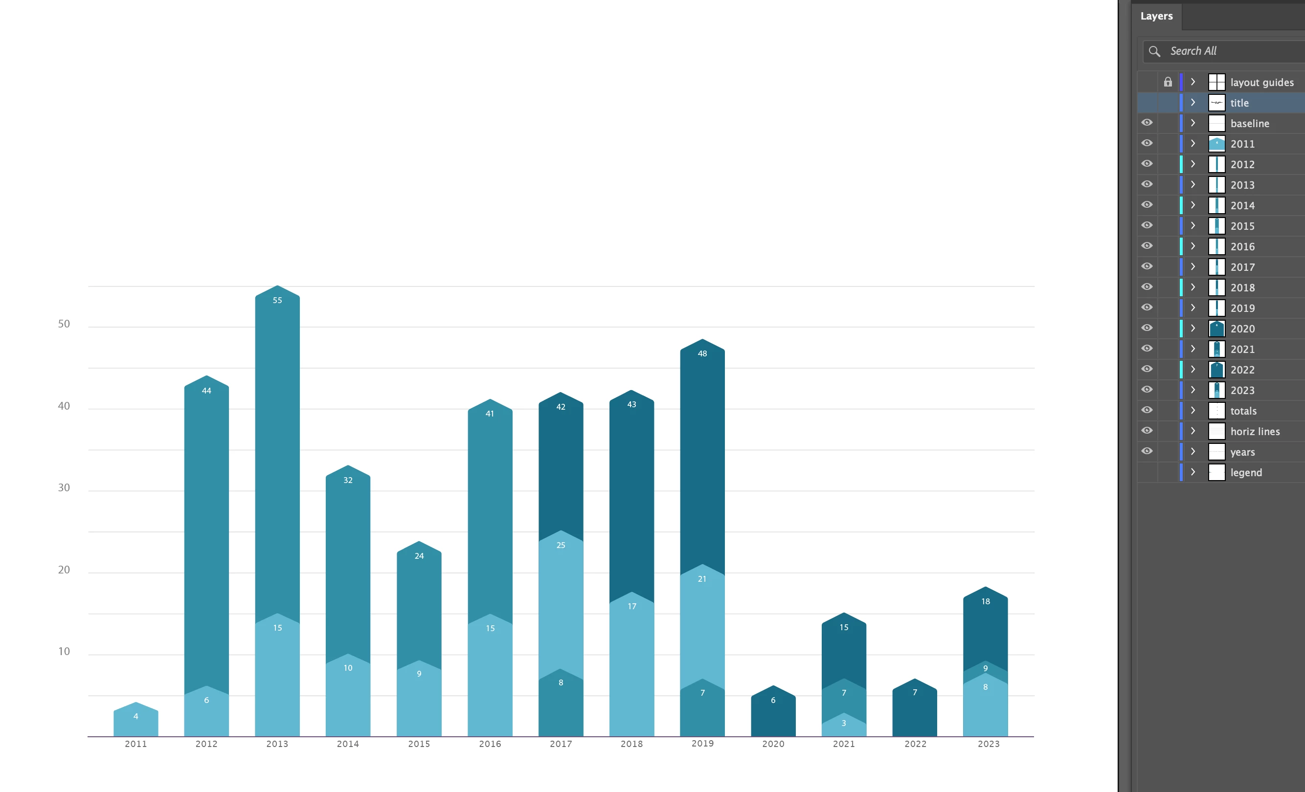

I created 3 nearly identical bar charts using no linked/embeded/external art. Everything is just text labels and rectangular objects. Two of the charts are under 500kb but, one chart is 18mb, and I don't understand why.
I had intended to email the AI files to the client so they could update statistics in the future. But, this one file is really large to email, and doesn't match the others in size.
All files are 8.5x11, RGB color space.
Each file has about 20 layers, sharing a common naming scheme between them.
No Groups or sub-layers.
Show All is grayed-out.
The Links panel is empty.
I have checked each layer and there is nothing other than the text label and rectangular object.
Saving As or Save A Copy results in the same file size.
Saving with/without PDF compatible makes no difference.
If I copy the contents to a new blank document, then the file size is normal. But, I loose all my layer organization in the process. It's a pain to recreate the layer names and organization.
What could possibly be the hang-up with the large file size?  Thanks.

Ton FrederiksCorrect answer
June 13, 2025
To keep the layers during copy/paste, check the "Paste Remembers Layers" in the Layers panel menu.

salfavataAuthor
June 13, 2025
Thanks, Ton. Always a delight to learn new features about AI. Your solution worked as described, the new file size is normal. And, I will never know why the original file is so humongus, but it doesn't matter at this point. Problem solved.
