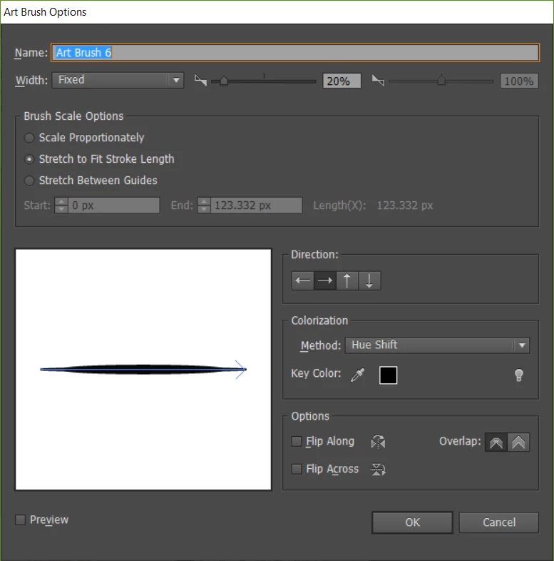

- I thought it might have something to do with my brush settings but I have no idea what I'm doing in there so here's a screenshot of my brush properties

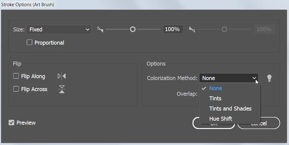

If you change colorization method to None, the brush will always be the same color as it was when you first created it.
If you choose Tints or Hue Shift, because your brush has only one color, it will be whichever color your stroke color is at the time you use the brush.
Tints and Shades, because your original brush is black, will give you black.
Note that if you had a multi-color brush, the results would be different.
Clicking the Tips icon (looks like a light bulb) will give a short description of each colorization method.

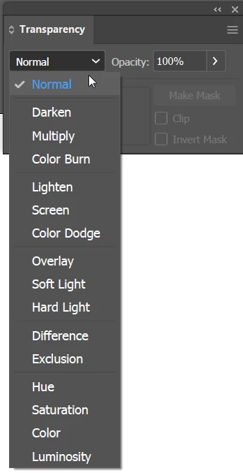

Do you have a blend mode other than Normal?
