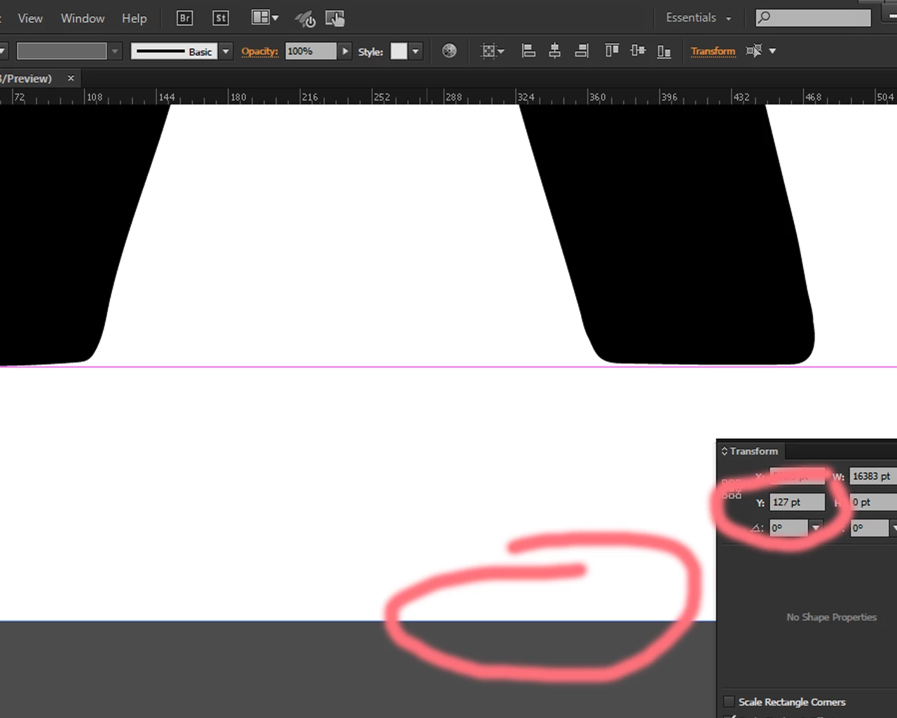

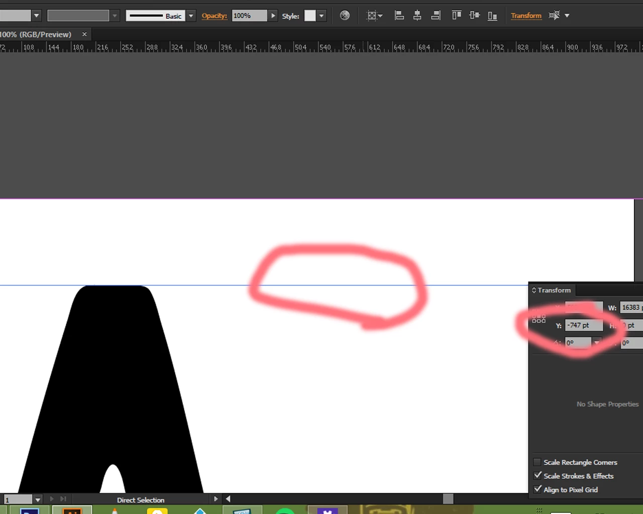

Im setting up a typeface that will be pasted onto Fontlab. Ive set up mostly everything BUT now that im looking at the values of each Y axis to find my ascender, descender, etc.. the numbers are backwards. My descender is valued positive and my cap height is negative.
I was wondering if anyone has had this problem and if they have found a fix??
I havent been able to find one and i cant really keep working on the typeface with this dilemma

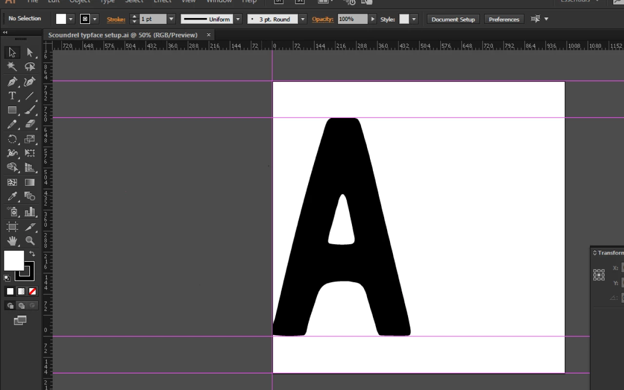

Can you show us a screenshot that has the vertical ruler in it?
January 24, 2018
Theresa J
January 24, 2018
Your vertical 0 coordinate is set at the bottom of the art. Double click in the upper left corner, in the ruler margin to reset the 0,0 coordinates.
