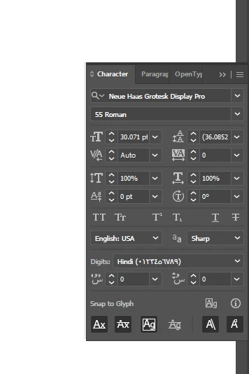

When I type (') it turns into (>) (check below):
Correct answer SGG CREATIVE
Thank you. This helped.
For anyone wondering, see the screenshot. The place that says English: USA was set to Arabic. This was the cause of the issue.

Seems the language was set to Arabic in the Text Box, when I turned it into English, it worked.
SGG CREATIVECorrect answer
July 19, 2023
