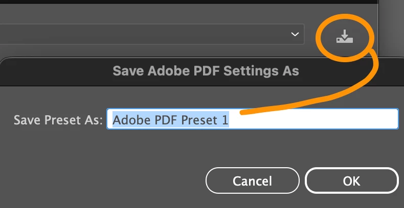

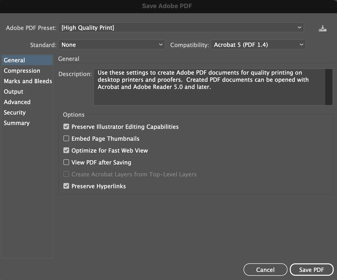

    ​@cmm_3239 If I save as a PDF and select High Quality Print, it will automatcailly pick Acrobat 5 (PDF 1.4)
    You could also save your own preset and you can select it all the time and get your set-up all the time:
