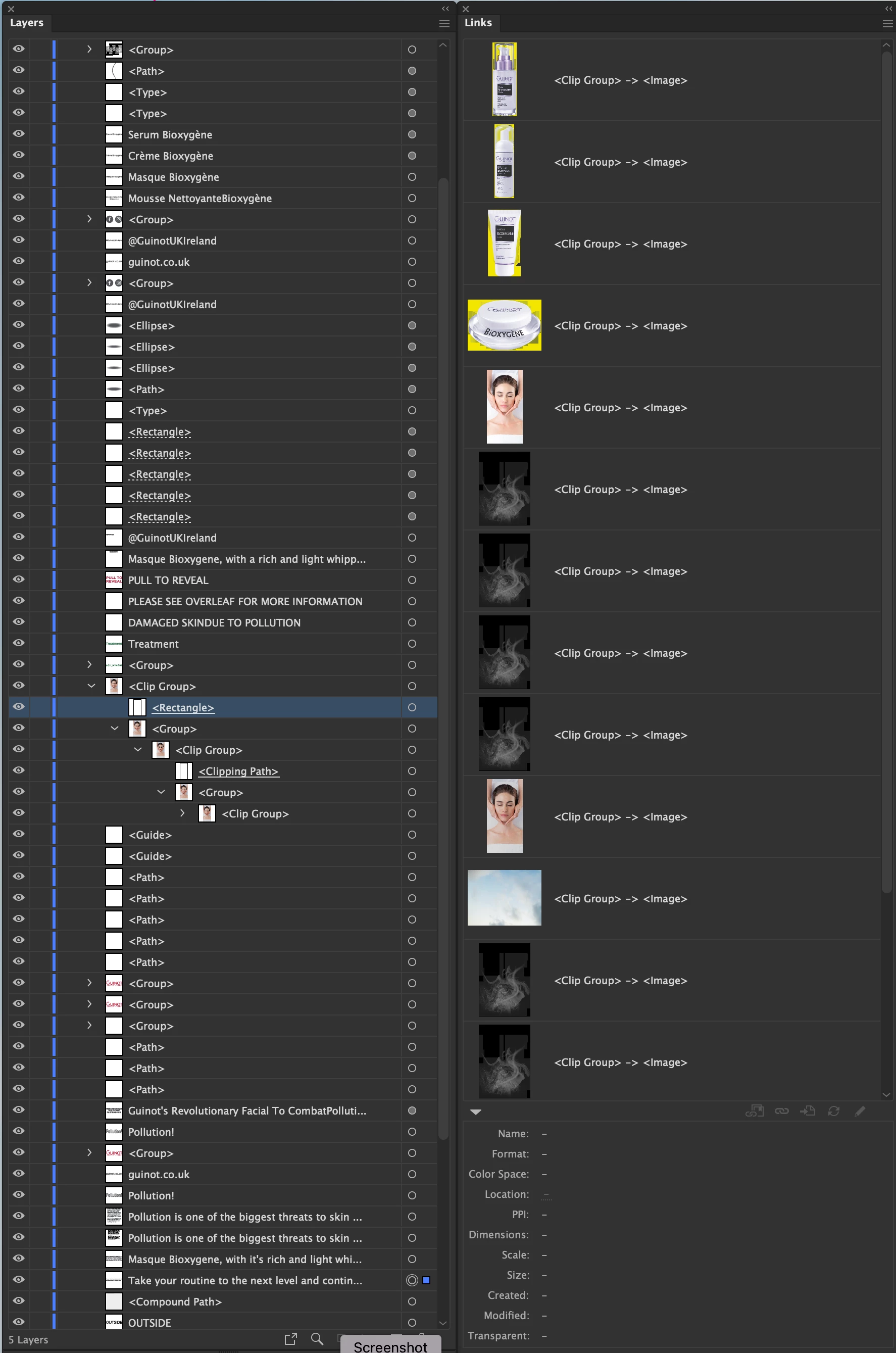

I am importing a image into illustrator and when I close the file and reopen it - it changes the links to
<Clip Group> -> <Image>
Why is it doing this and hoe can I disable it??

What was the settings of the import? Was it with "Link" option or not?
Could you please show the screen with the Layers and Links panels expanded?
If content is sensitive, you can zoom it to show just part of the artwork, we need mainly panels to say something helpful.
ah3971403
ah3971403Author
Jun 13, 2022 12:15 PM UTC
Hi Anna, Thank you...
Please see above...
I'm not sure if I pressed some shortcut keys or selcted something without knowing
Anna Lander
Jun 13, 2022 1:14 PM UTC
As far as I can see here are 2 things:
1. You placed the images without the Link option. In this case Illustrator embed the image into the document and break all links to the original (including its name).
2. The clipping masks may be created by yourself or by the program itself if you place, for example, PDF format. What format have the images?
try to relink any image (click on the "chain" icon on the Links panel) and reselect the image in the folder with the Link option turned On. And then tell please what happens.
