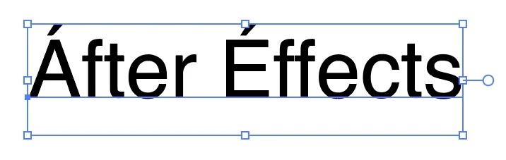

Recently switched from affinity designer to Illustrator, and this seems a bit strange. Why is the bounding box of a text layer taller than the letters themselves?
There's no "return" at the end of the line and this happens on all fonts, even on basic ones like Helvetica.
Any way to fix this or maybe someone can explain why this happens?

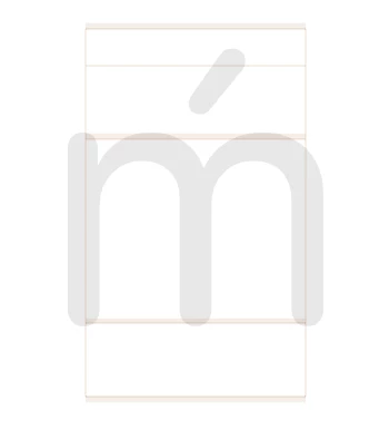

There needs to be room for accents.
November 7, 2023
Sure, what about that space at the bottom though?
Monika Gause
November 7, 2023
It's for the descenders.
This is the space around letters. Illustrator just shows it all with its bounding box.

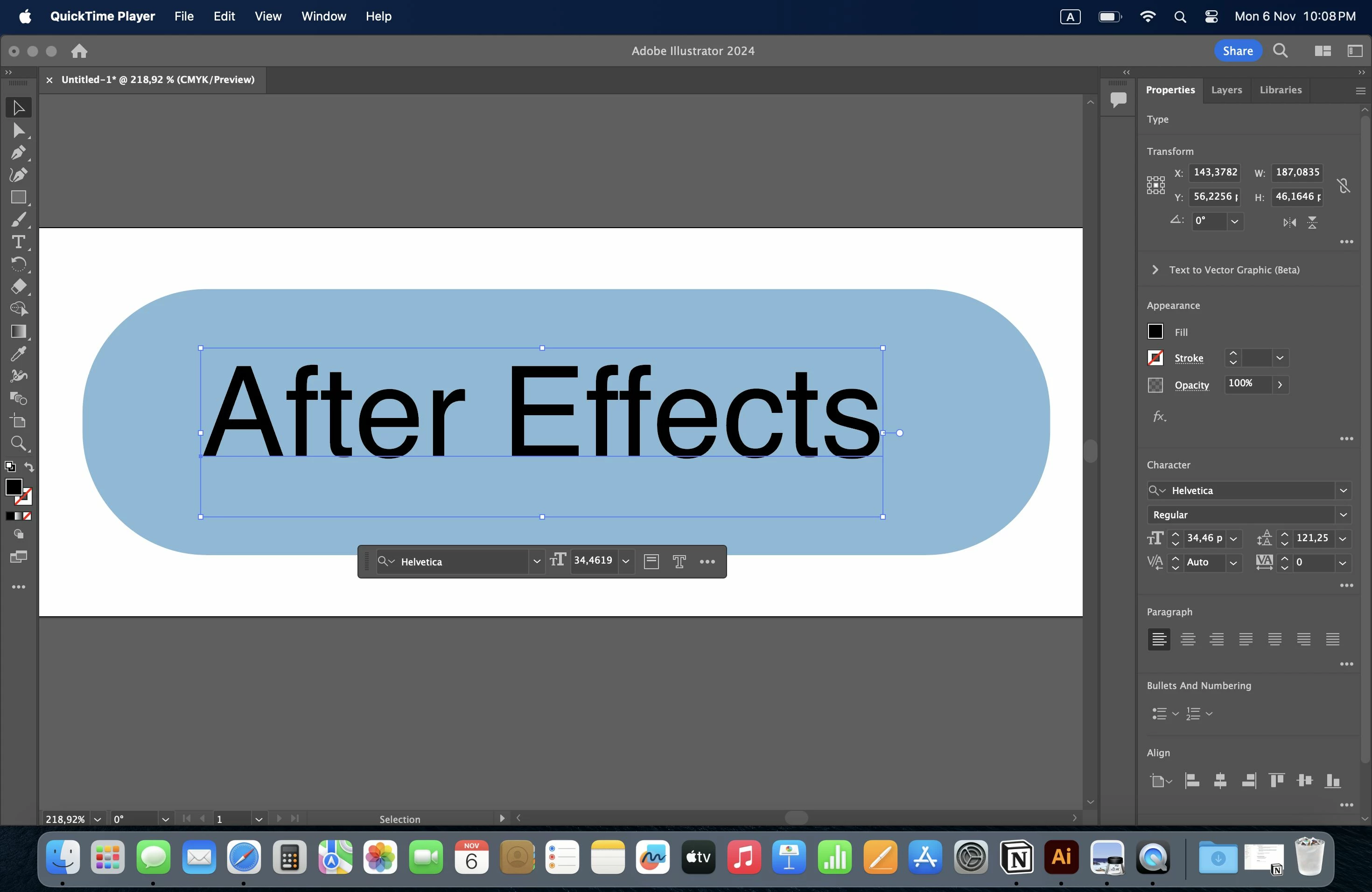

Well, I just want to align the "After Effects" text directly in the center of the blue rounded rectangle in the back, but since the text within its bounding box is not center to begin with, I can't align it properly, if that makes sense. It just looks off center vertically.
Monika Gause
Monika GauseCommunity ExpertCorrect answer
November 6, 2023
You can do so in the Align panel. In its panel menu you can turn on the ALign to glyph options.
But beware: The text needs to have slightly more distance to the bottom than to the top for optical reasons.
