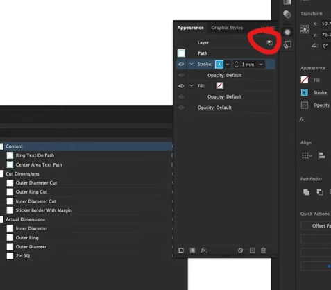

Doug A Roberts
July 14, 2025
There is an appearance applied to that layer. Double-click 'Layer' in the appearance panel to view it:
July 14, 2025
Thanks, @Doug A Roberts --- didn't even know that was possible!
Thanks!
