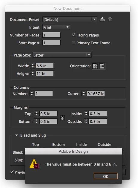

January 12, 2017
Make your Artboard in Illustrator large enough to include Bleed for the art. Then Place the art in a new inDesign file that includes the 1" Bleed you need.

If this is a layout, you may want to consider creating it in InDesign. The maximum Bleed is 6" in ID.
