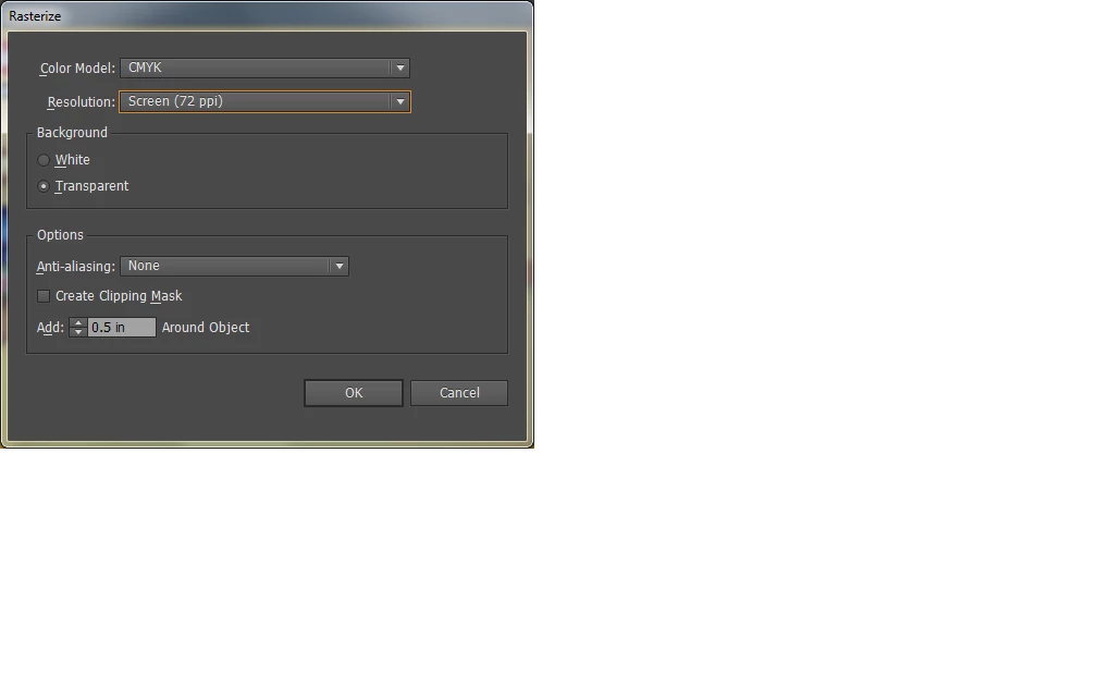

Hello guys.
I have illustrator file scalle down for 7 inch by 8 inch, it has Images, vectors, and raster effects, that actual size i want is 7ft by 8ft, I eport it as tiff in 300dpi, and open it in photoshop and scalled up to actual size, the file is totaly blured, how can i export it same size and scalled up without any blury,
i attached raster value below,
Thank you

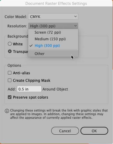

1) You need to realize that while Adobe Illustrator is a vector-illustration program, it widely applies raster effects to your vector drawings. Stylizing effects like drop shadows, bevel and emboss, etc. are applied the same way as they are in Photoshop — by "painting" in soft transitions with pixel-based information. There are also other areas — like some gradient effects, placed art, etc. where raster effects can come back to bite you. You need to account for that raster effect information when you trnasition into creating rasterized output for your Illustrator file.
2) When you create rasterized art, you need to account for your effective resolution needs for the final output size, and take that into the account from the beginning of the process.
Both of these factors may be affecting your scaling issues when you create your rasterized art. Let's deal first with your raster effects. Before you rasterize your art, you need to ensure that you're getting sufficient effects resolution inside your existing vector art.
By default the Document Raster Effects Settings options box, which you access through the Effect>Document Raster Effect Settings... menu command, gives you three standard settings for your raster effects output — Screen, Medium and High, as shown below. There's also an option for dialing in an Other resolution:
As we discussed earlier, since image resolution is fixed when you create rasterized information, you need to account for needed effective resolution at the final reproduction size. I'm going to make an assumption that your 7' x 8' final graphic is being created with large-format printers for signage/banners. So I'm going to shoot for a final effective resolution of 75 pixels per inch (ppi) for two reasons: one is that this is a common specification for this kind of work; the other is that using that number makes the math easier.
We need to dial in a custom number for our effects, since we're scaling up twelve times the original size of the art. Since we need an effective resolution of 75 ppi for final reproduction size, and were scaling up 12 times, the math translates to 75 x 12, or resolution of 900 ppi.
If we have any raster effects whatsoever, we need to first scale up the resolution of the effects to preclude rude surprises when we rasterize the art for final use. Otherwise, you'll get great results with the right settings for all your rasterized vector art, but your effects will be hopelessly messed up.
Now let's address your rasterizing problem directly. Rasterizing at 300 ppi and blowing up the art 12 times gives you a final effective resolution of 300 ÷ 12, or 25 ppi. That appears, as you report, as really blurry in Photoshop and if you try to print that out, it'll give you a linescreen value coarse enough to sand a hangnail down. When you rasterize the job, you can either manually dial in the correct Other resolution at final reproduction size (75 lpi x 12, or 900 ppi), or you can use the correct Document Raster Effects settings we've already dialed into this job.
This should get you the results you're looking for. But before you go further, check with who will be producing your job to get their desired specifications, and apply these factors to come up with precisely the resolution you need for your job.
