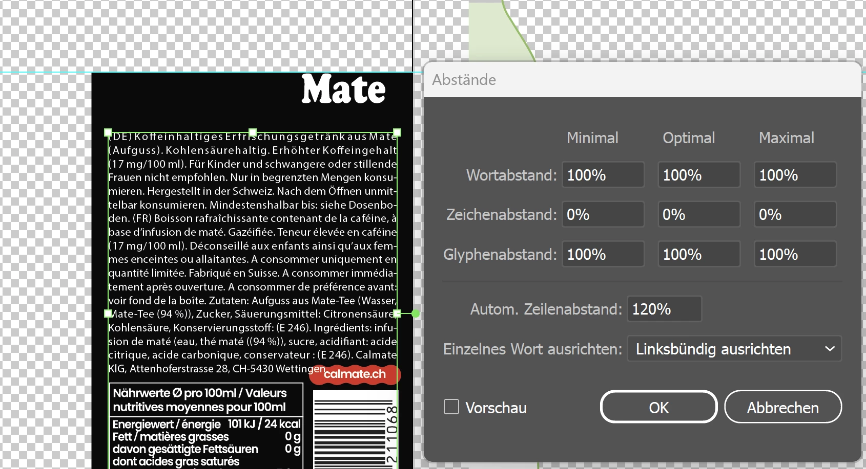

Wie kann ich die grossen Abstände innerhalb vom Blocksatz entfernen?

    ​@athletic_Lightning5D89 You can check if changing the composer to Every Lin Composer in the Paragraph panel menu will improve it and check this Help file:
    https://helpx.adobe.com/de/illustrator/desktop/design-with-text/edit-format-text/adjust-word-and-letterspacing-in-justified-text.html

    Monika Gause
    Jun 20, 2026 10:41 PM UTC
    Alle diese Werte auf 100% zu setzen macht überhaupt keinen Sinn. Man muss dem Absatzsetzer Spielraum geben, damit er das optimieren kann.
    Ton Frederiks
    Jun 20, 2026 6:56 PM UTC
    I don’t think it is useful to set the Maximal to 100%

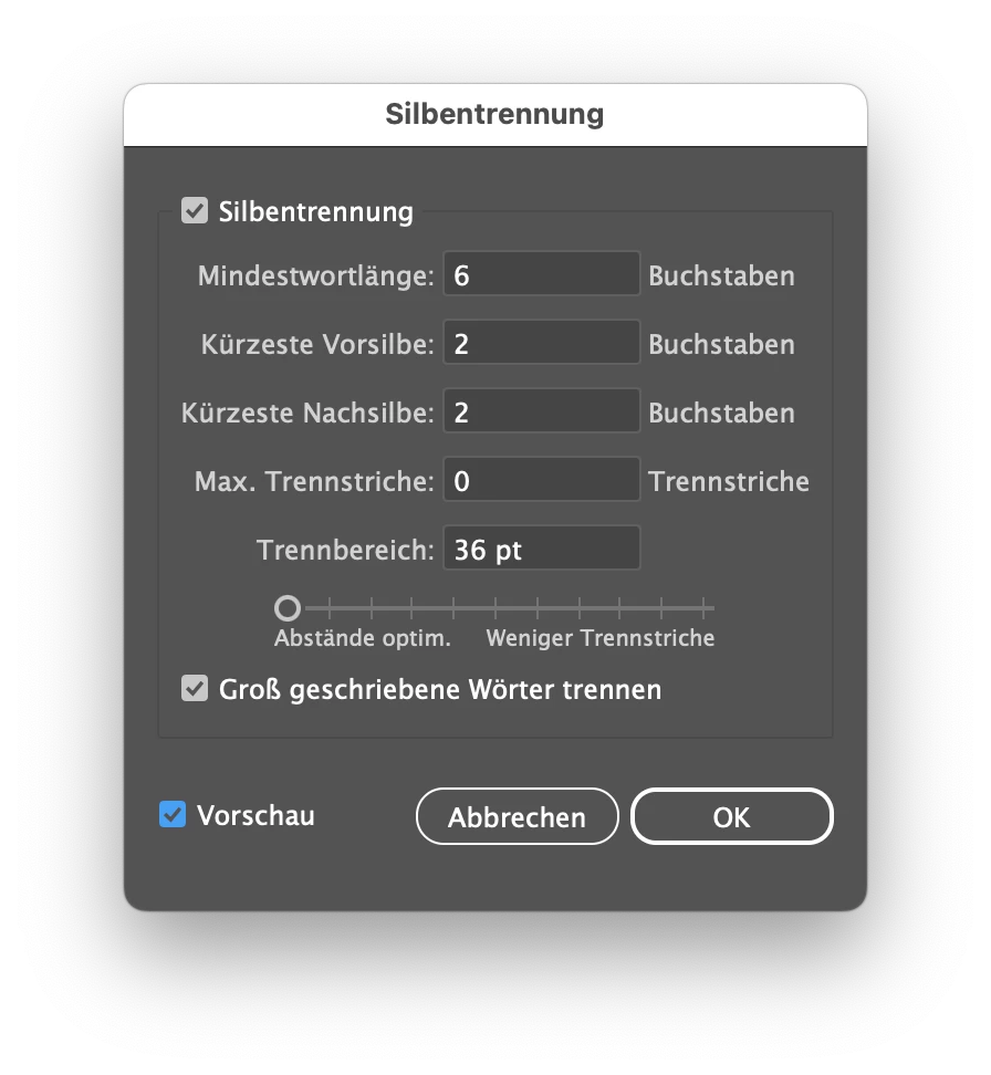

    You may want to increase the number of hyphens.
    Ton Frederiks
    Jun 20, 2026 6:23 PM UTC
    You could try adjusting the hyphenation settings.

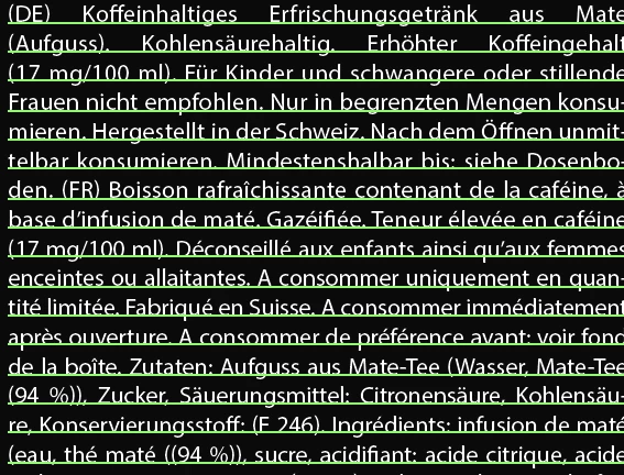

    Jun 20, 2026 6:12 PM UTC
    Thank you for the advice. Is there a away to remove to weird stretch effect on the first sentance?
