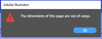

Workflows that need large canvas / artboard
Illustrator supports maximum artboard size of 227 x 227 inches / 577 x 577 cm.  In which workflows you would use canvas / artboard size greater than 227 x 227 inches / 577 x 577 cm?
Those who create design for billboard and large format printing, would you prefer design in actual size instead of scaled design (1/10 or reduced proportion of actual size)

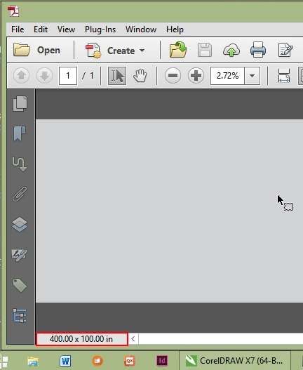

We save all of our artwork as PDF to our RIP. I believe there is a certain limitation to PDF files - somewhere around 5 meters I think... if we work at 100% on artwork over 5 meters would we still not need to scale the artwork down to under 5 meters to save successfully as a PDF?
MW Design
May 12, 2017 3:28 AM UTC
PDFs themselves can go much larger. The 200" x 200" limit was lifted with PDF 1.6 if I recall. It was raised to 15,000,000 inches...also if I recall. It's just that Acrobat was never updated to display such a thing without a bodge.
Which is why I posted above that the Illy team needs to get the Acrobat team on-board and raise this artifical limitation of Acrobat for viewing. Most other decent PDF viewers do not have this limitation. They just don't work properly in a press-workflow and are in no way a replacement for Acrobat. The above PDF is 400" by 100" and is viewable in Acrobat. but it is a bodge, though some RIPS will accept it.
So what I do in CorelDraw when I don't know where it will be printed, is design at 100% scale, then group everything and scale down and change the page size that an unknown RIP can handle along with instructions to scale up X percentage.
