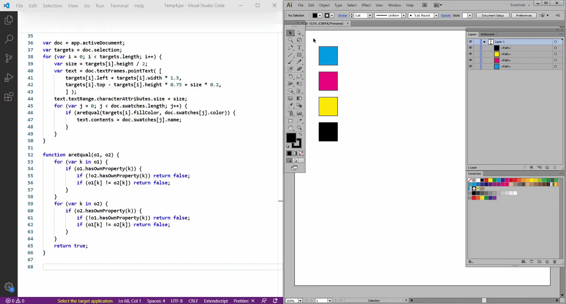

If I understand correctly, you want to select the colored squares, run the script and have it write the names of the corresponding swatches to the right of the squares.
var doc = app.activeDocument;
var targets = doc.selection;
for (var i = 0; i < targets.length; i++) {
    var size = targets[i].height / 2;
    var text = doc.textFrames.pointText( [
        targets[i].left + targets[i].width * 1.5,
        targets[i].top - targets[i].height * 0.75 + size * 0.2,
    text.textRange.characterAttributes.size = size;
    for (var j = 0; j < doc.swatches.length; j++) {
        if (areEqual(targets[i].fillColor, doc.swatches[j].color)) {
            text.contents = doc.swatches[j].name;
function areEqual(o1, o2) {
    for (var k in o1) {
        if (o1.hasOwnProperty(k)) {
            if (!o2.hasOwnProperty(k)) return false;
            if (o1[k] != o2[k]) return false;
    for (var k in o2) {
        if (o2.hasOwnProperty(k)) {
            if (!o1.hasOwnProperty(k)) return false;
    return true;

Thank you for this, I have just tried but it's not what I'm looking for. What you shared is directly creating a library of my swatches.
I need to create a square with X colour, click on it and then run the script so it creates the name next to it.
I need it like this because everytime I create a new artwork I use different colours from that swatch and I only need to show the ones that are used, not the whole swatch. I have 89 colours and some of them are very similar, that script would help me not having to check the swatch everytime and write it manually.

what about the following snippet code
function main() {
  var obj = {
    dialog: "dialog",
    w_name: "Create swatch",
    orientation: "orientation",
    column: "column",
    row: "row",
    statictext: "statictext",
    Panel: "panel",
    group: "group",
    edittext: "edittext",
    listbox: "listbox",
    actDoc: app.activeDocument,
    copyright: "Gdelgado2023 | version 1.0 | ",
  var doc = obj.actDoc;
  var swatNames = Array();
  var contSwatc = doc.swatches.length;
  for (var i = 2; i < contSwatc; i++) {
    swatNames.push(doc.swatches[i].name);
  var w = new Window(obj.dialog, obj.w_name);
  var Pnl1 = w.add(obj.Panel, undefined, "Color 1");
  Pnl1.orientation = obj.row;
  var grp1 = Pnl1.add(obj.group);
  grp1.orientation = obj.column;
  var entryPC = grp1.add(obj.edittext, [0, 0, 140, 20], "");
  entryPC.active = true;
  var myList = grp1.add(obj.listbox, [0, 0, 140, 100], swatNames.sort());
  w.add(obj.statictext, undefined, obj.copyright);
  entryPC.onChanging = function () {
    var temp = this.text.toLowerCase();
    myList.removeAll();
    for (var i = 0; i < swatNames.length; i++) {
      if (swatNames[i].toLowerCase().indexOf(temp) == 0) {
        myList.add("item", swatNames[i]);
  myList.onChange = function () {
    var selText = this.selection.text;
    entryPC.text = selText;
    var w = 100;
    var h = 100;
    var top = 0;
    var left = 0;
    var rect = doc.pathItems.rectangle(top, left, w, h);
    rect.fillColor = doc.swatches[selText].color;
    var mylabel = doc.layers[0].textFrames.add();
    mylabel.contents = doc.swatches[selText].name;
    mylabel.left = left += w + 10;
    mylabel.top = top -= h / 2;
    close();
  function close() {
    w.close();
  w.show();
try {
  main();
} catch (e) {
  alert(e.message + "\n" + "error on line " + e.line, "\u274c", true);
