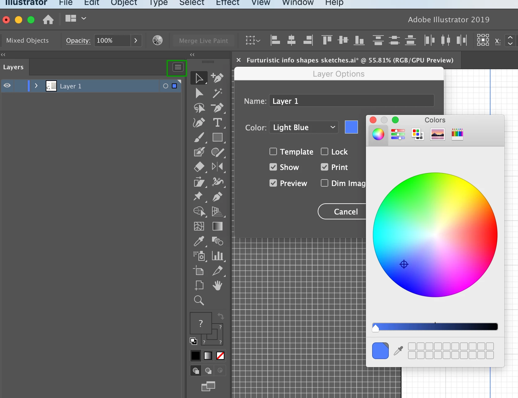

Suddenly, when I click on an object in Illustrator, the bounding boxes are yellow. It is impossible to work with. I can't find the answer online. Any ideas?
    Monika Gause
    Monika GauseCorrect answer
    April 11, 2019
    Double click the layer in the layers panel to change its color.
    8 replies
    Simmer1
    April 11, 2019
    You can find the dropdown menu here
    hammer0909
    April 11, 2019
    It seems that you or someone else has adjusted the Layers in the document from what you are used to. The bounding box color is reflecting the color indicated in the Layers panel. If you select one of the objects, you should see a small square to the right of the layer that the object is on in the Layers panel. As Monica pointed out, you should be able to simply double-click on that layer and choose a new color from the drop-down menu, then click OK. This color is only for visual reference and won't appear in the final product. It can however make things difficult to see depending on what color is being used (in your case yellow).

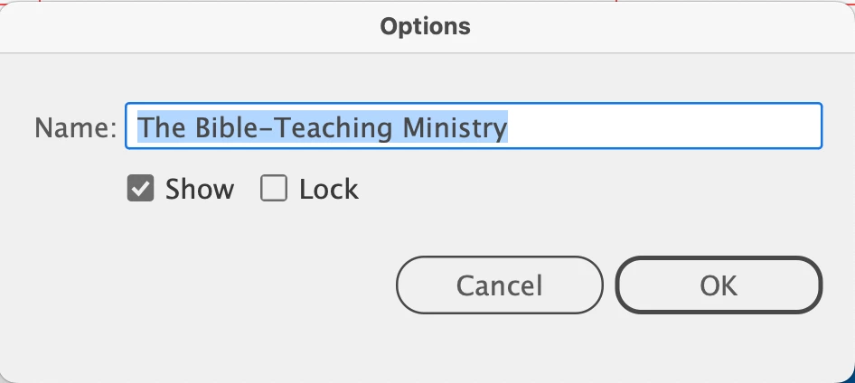

    I'm having the same problem. Whyis yellow even an option? When I double-click the layer, the only option it gives me is to show or lock the layer, nothing about colors.
    February 11, 2025
    I did paste the text layer that I'm trying to change from another Illustrator document, if that makes a difference.
