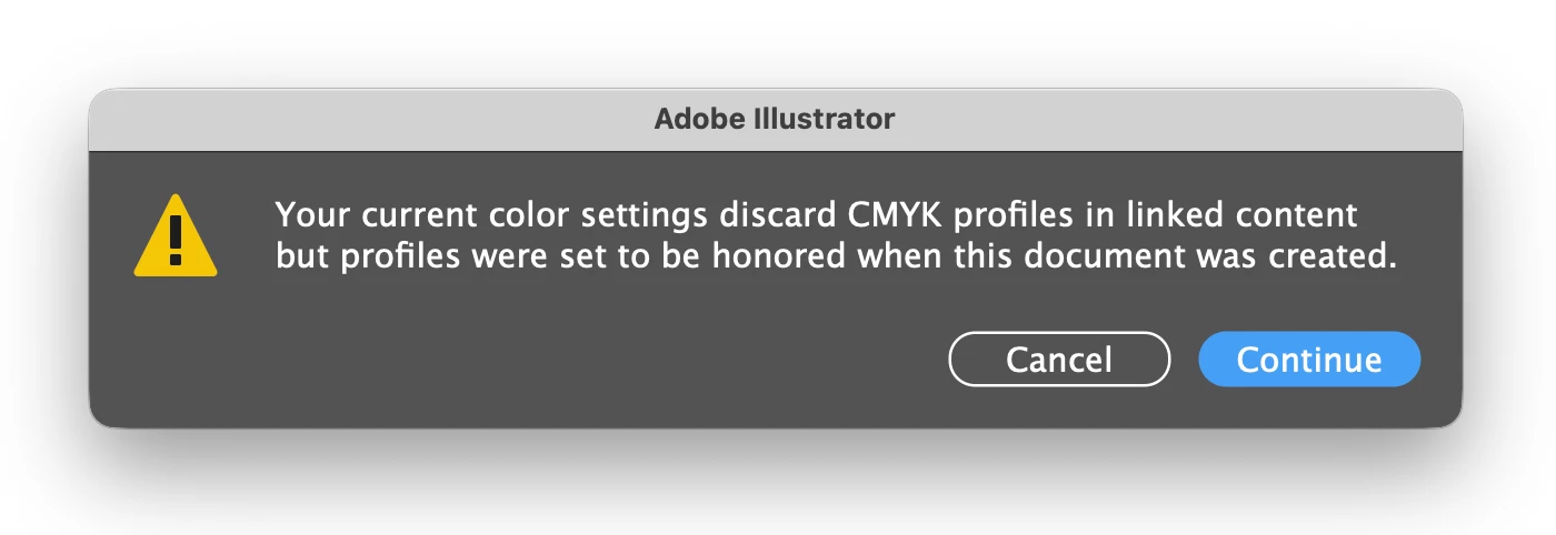

"Your current color settings discard CMYK profiles in linked content" error message
I keep getting the following error message:
"Your current color settings discard CMYK profiles in linked content but profiles were set to be honored when this document was created."
every time I open an Illustrator document. I have no idea how this setting was set and no idea how to turn it off. I am just using the standard N America Prepress color setting in Bridge.
I have tried opening new documents using the supplied Ai CS4 new document profiles, no luck. So I am assuming it's a pref that is set in the app itself, yet I have no idea how to change this setting? I don't even see anything referring to a setting like this.
I found this archived discussion: http://www.adobeforums.com/webx?128@@.59b58d84 which had no resolution. Thought I would throw it out there again and see if anyone has been able to fix this. It drives me insane having to deal with that error every time I open a saved document.

    I'm glad someone asked this. This fix seems to just cover up the problem. I would like to understand exactly what it's seeing and how to fix incoming art or what my workspace management policies should be and why. I can design stuff but I don't understand all the technical coloring stuff that my presses need.
    If you receive files from other people then the only way to get rid of the error is to set up your environment just as they did.
    This warning is just a notification that different settings have been used. The setting the warning is reminding you of, concerns how CMYK profiles are handled. Will a profile mismatch cause Illustrator to convert color according to the different profiles? Or will Illustrator keep the numbers and discard the different profile.
    In CMYK most of the time you want to keep the numbers, because you don't want 100 K black to be converted into something dirty and you don't want a 100% yellow converted to something that has some percent of dark ink in it.

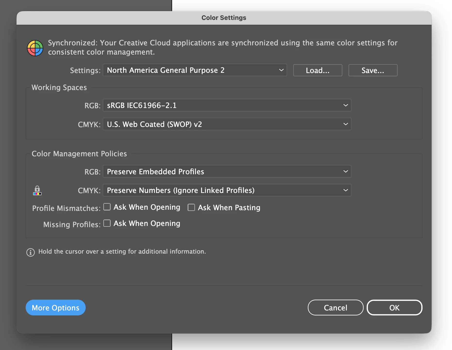

    Dec 13, 2022 4:32 PM UTC
    So I think I figured it out.
    Edit > Color Settings > Color Managment Policies > CMYK drop down to "Preserve Embedded Profiles"
    Not sure why that's not the default.
    Monika Gause
    Dec 13, 2022 4:45 PM UTC
    quote
    By @Nitteina
    It's not the default, because it can lead to muddy black when exporting to PDF into a different profile.
    The message about that "your current color settings ..." is not an error. If you change your color management setup in order to not receive messages about other peoples' files, then you're doing it wrong. Your color settings should match your workflow.

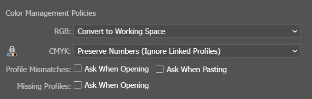

    MONIKA'S REPLY:
    For vector content "Preserve numbers" is the best choice, because CMYK vector content most of the time cannot be handled by the ICC based conversion workflows. Converting colors based on ICC profiles will make a mess of your colors most of the time.
    For raster artwork (and this also affects raster images placed into your vector files) you sometimes need to do profile based CMYK to CMYK conversions.
    I have mine set to Preserve numbers. YMMV.

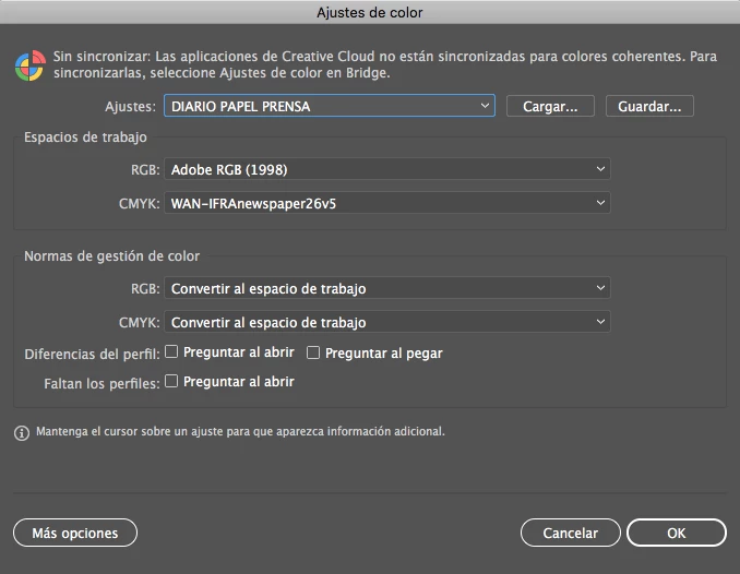

    May 3, 2018 8:58 PM UTC
    Sorry for making alive an older post.
    I have the very same problem.
    - I am pretty sure my color management done right.
    - I did delete color preference,
    - I have all setting to Convert to Color Space
    - i have my images as RGB,
    - Questions unchecked
    - my document color mode is RGB and
    still getting the very annoying "Your current color settings discard CMYK profiles in linked content but profiles were set to be honored when this document was created."
    My Color Settings (RGB for web / CMYK for Newspaper)
    what am i doing wrong?
    By the way how can i install a script in Illustrator?
    Thanks again ;-)
    Monika Gause
    May 3, 2018 9:29 PM UTC
    You need to set the "Normas de gestion de color" to keep the embedded profile.
    To install scripts, please read the documentation:
    Automation with scripts in Illustrator
    Scripts go into the Scripts folder inside the Presets folder inside the Illustrator application folder.
    btod27906334
    May 4, 2018 12:43 AM UTC
    Thanks for the fast reply Monica
    I thought i already did that by selecting "Convert to workspace" on. Am i doing it wrong?

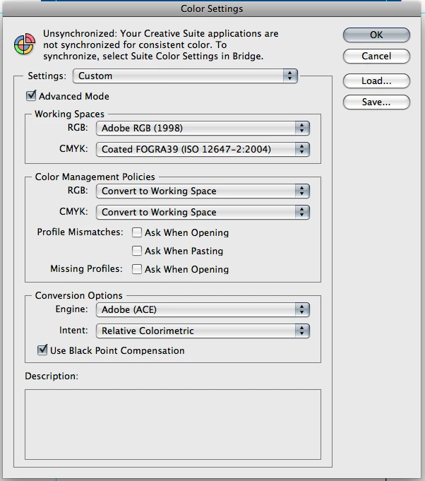

    May 20, 2013 4:41 PM UTC
    Well, i am not expert and i dont know if i make something wrong, but i have the same problem with the error alert about the color settings in CS5, and what i did work for me just fine.
    menu edit > color settings > color management policies
    change the settings to 'convert to working spaces'
    Close the program,
    I went to Library - Preferences - Adobe illustrator CS5 Settings - en_US and delete the Ai color settings file....i re-open the program and it automatically generate a new ai color setting file and thats it...
    I think it can work also for the cs4.
    Hope it works for anybody having the same problem.
