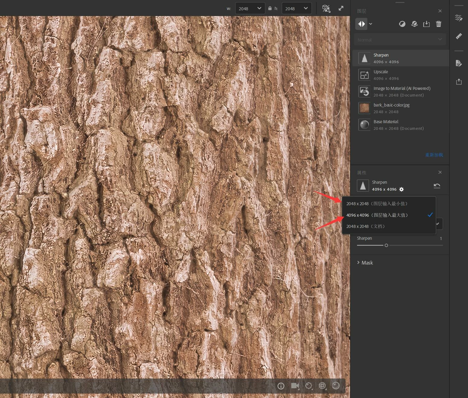

Add a filter on Upscale, which image resolution does it sample from?
Hello, this is my question about the new feature!
When I upgraded the image resolution from 2K to 4K and added a filter on Upscale, I then set this filter to - Layer Input Minimum value (2K) -
My question is, at this point, does the minimum value sampled by this filter come from the reduction of 4K images or from 2K images without any intelligent amplification!
Thank you very much
Cyril Dellenbach
Cyril DellenbachCorrect answer
Sep 6, 2023 12:06 PM UTC
Hello @锦阳28647702ckwc,
In the mentioned case, the top layer will not use AI, but a simple linear downscale from below layers. if you simply want to sharpen the result of the AI upscale, I advise you to keep the layer set at the same resolution as the upscale.

@Cyril Dellenbach      Okay, I understand. Thank you very much for your answer
