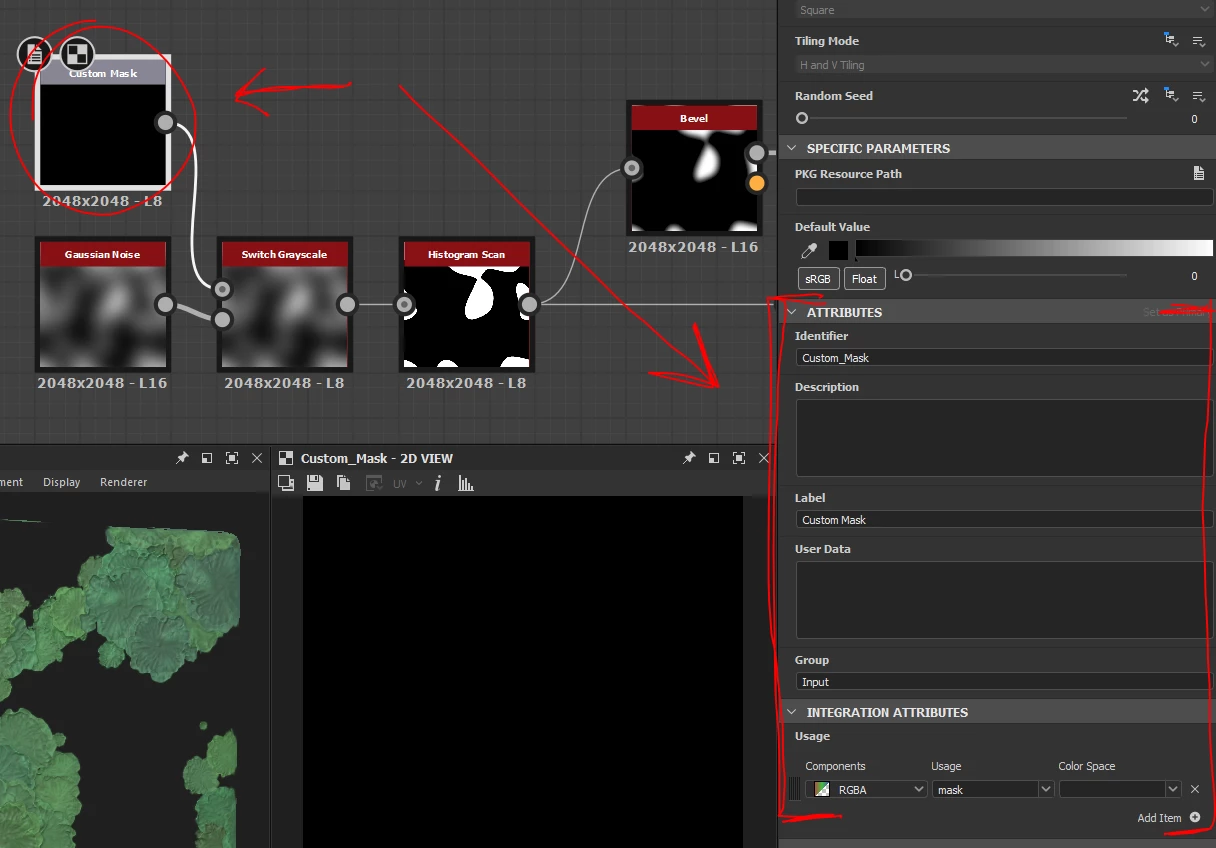

custom inputs from designer to sampler?
I can't find a way to expose my custom input nodes created in Substance Designer into Sampler.
They show up correctly in Substance Painter and in the old good Substance Player tho.
any hint?
thank you

Can you try to remove the usage of your custom mask input?
If there is a usage, we assume the input will be fed by a layer below in the layer stack.

Are you assigning a usage to the input nodes?
maxpuliero
May 2, 2023 12:00 PM UTC
thanks for the reply, yes I have something like this.
I also tried to reset my Sampler cache files in the roaming folder as suggested in other posts but it didn't work.
thank you
