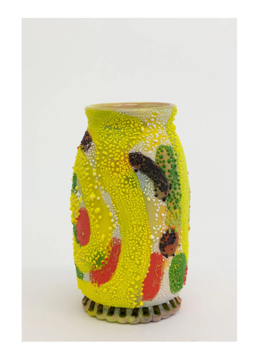

How do I create this kind of Glazed Texture?
I am new to 3D Design and Texturing.
I was wondering if there was a way to create this kind of glazed ceramic texture in substance 3d sampler?

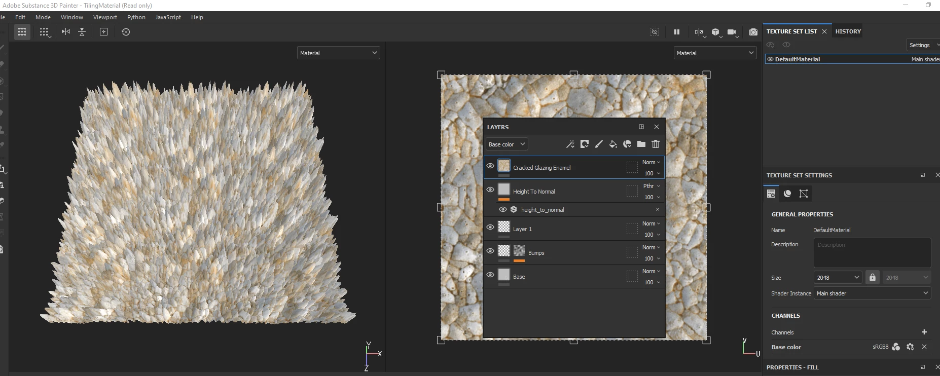

Substance 3D Assets (adobe.com)
Substance 3D Community Assets (adobe.com)
This are  links for glazed texture that you can download. Files can be open in Painter and designer that can help to understand how it was made. I also attach a screenshot of one material where you can see layers scheme.
