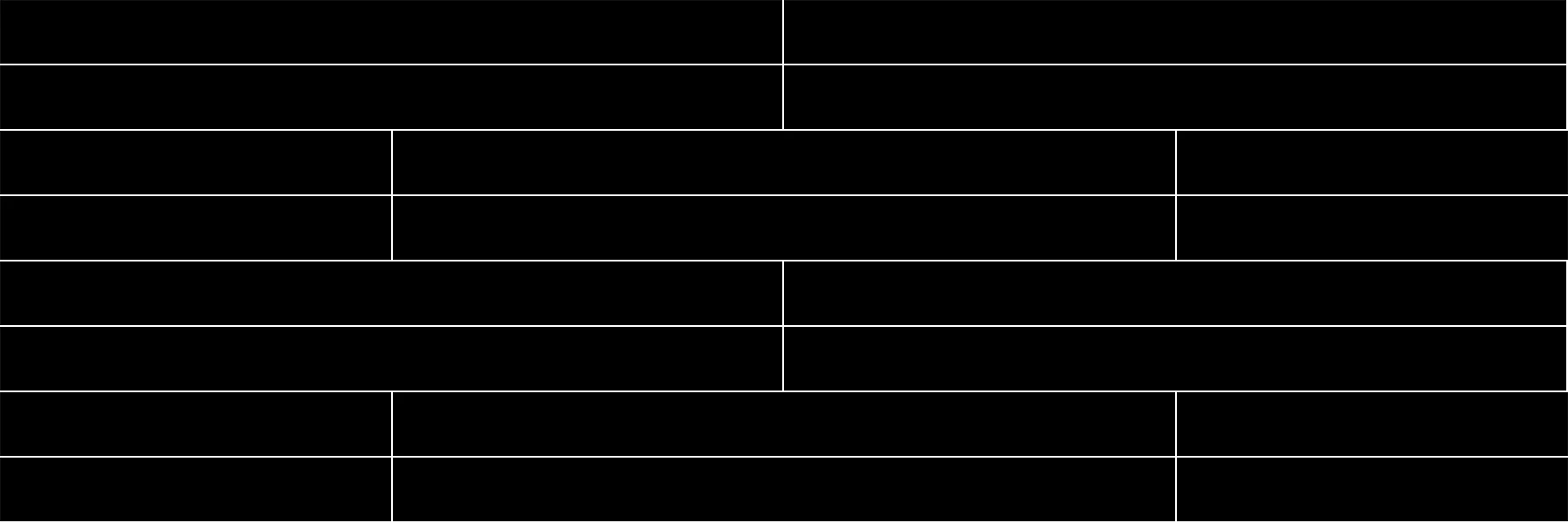

The joints of the flooring should have a clear indentation, and the board part should have a flat finish with no bumps. So I thought of preparing a black and white image that clearly separates the joint and the flat board parts, and use it to create a normal texture in Substance 3D Sampler.
If possible, I would like to create the normal texture from the black and white image, and the roughness texture from the flooring image, and be able to adjust them later. However, I don’t know how to do that. I would appreciate it if you could tell me how to solve this problem.

I hope I didn't misunderstand your point. I inverted your black and white texture and replaced it with a height map. I also added a height to normal filter to generate a normal texture and freely adjust the normal intensity. I think this is a good solution!

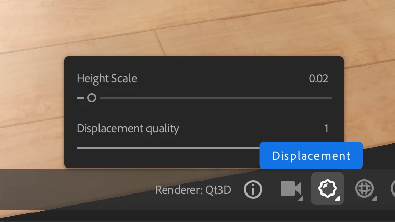

And you can adjust de Height scale in your 3D View:

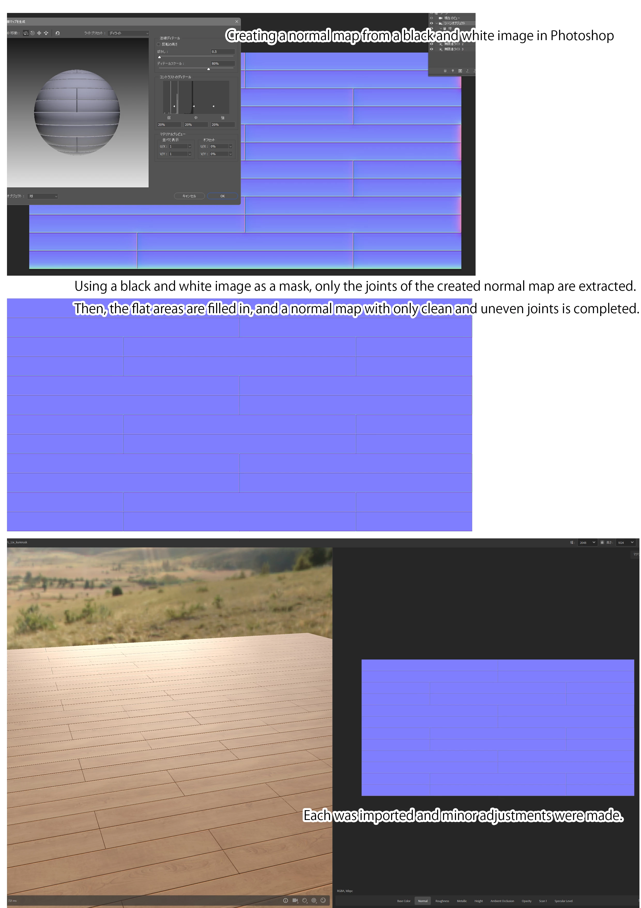

Thank you for your answer. I imported the texture with Image to Material (AI Powered) as you told me, and adjusted the parameters, but I couldn’t get the quality I wanted. Specifically, there are unwanted bumps on the flat board, and the joints are uneven and dirty. I think it’s best to create and adjust normal maps from black and white images in photoshop, import the texture and normal maps separately into SubstanceSampler, make minor adjustments, and output the final material. …But this workflow doesn’t make much use of SubstanceSampler. Also, photoshop’s normal map creation feature will be discontinued in the future. I hope that a feature that can create simple and beautiful normal maps from black and white images will be added in the future.
