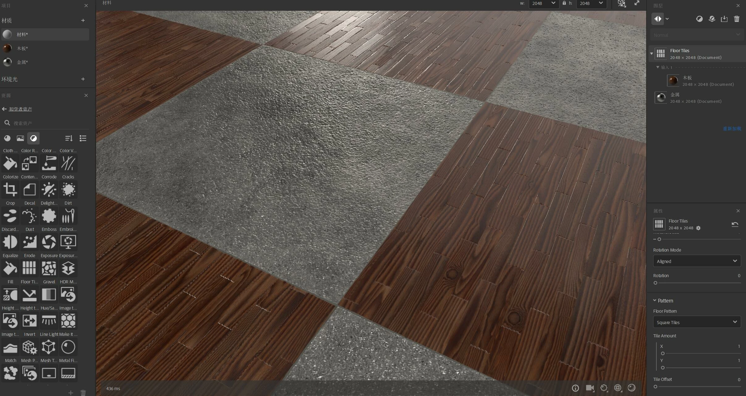

Oct 2, 2023 4:29 PM UTC
Perhaps you can use "Floor Tiles", which can make multiple different materials appear on a tile. I'm not sure if I understand your needs correctly. You can take a look at the pictures I provided
PixelFunAuthor
Oct 2, 2023 9:59 PM UTC
I tried it with a tiling filter like floors, but I couldn't create the mask as I would have needed it. A simple mask filter would be so handy. Thank you very much for your idea, appreciate it!
