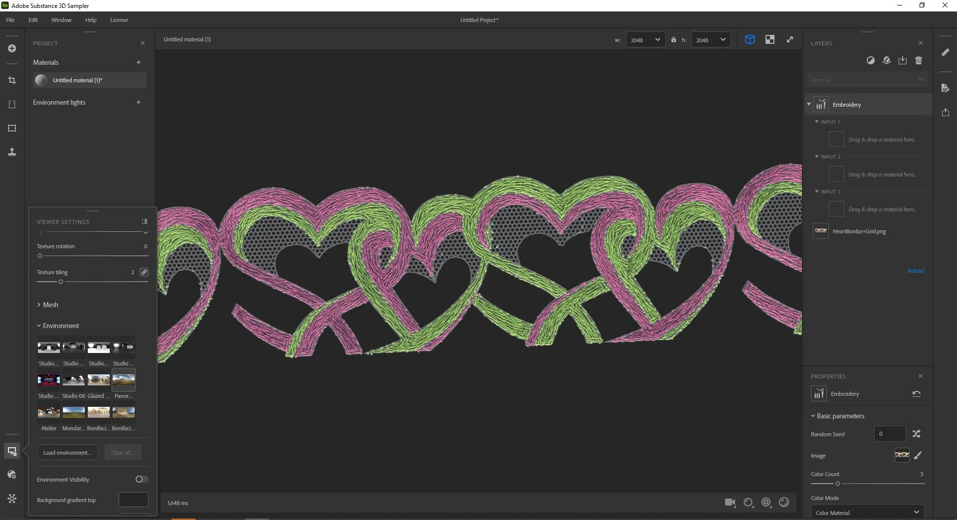

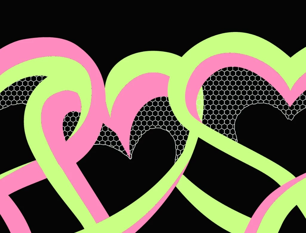

Hi
I can't create a grid of threads like in the photo. They look flat and gray. If I work with the Weave function, the black color appears. I will add screenshots. And an additional image of the graphics I'm working with. Please help to make a net with white threads)

I've tried to put a "Brightness/Contrast" Filter (and mask only the mesh part) and I was able to lighten it.
So it might be a workaround to your issue.

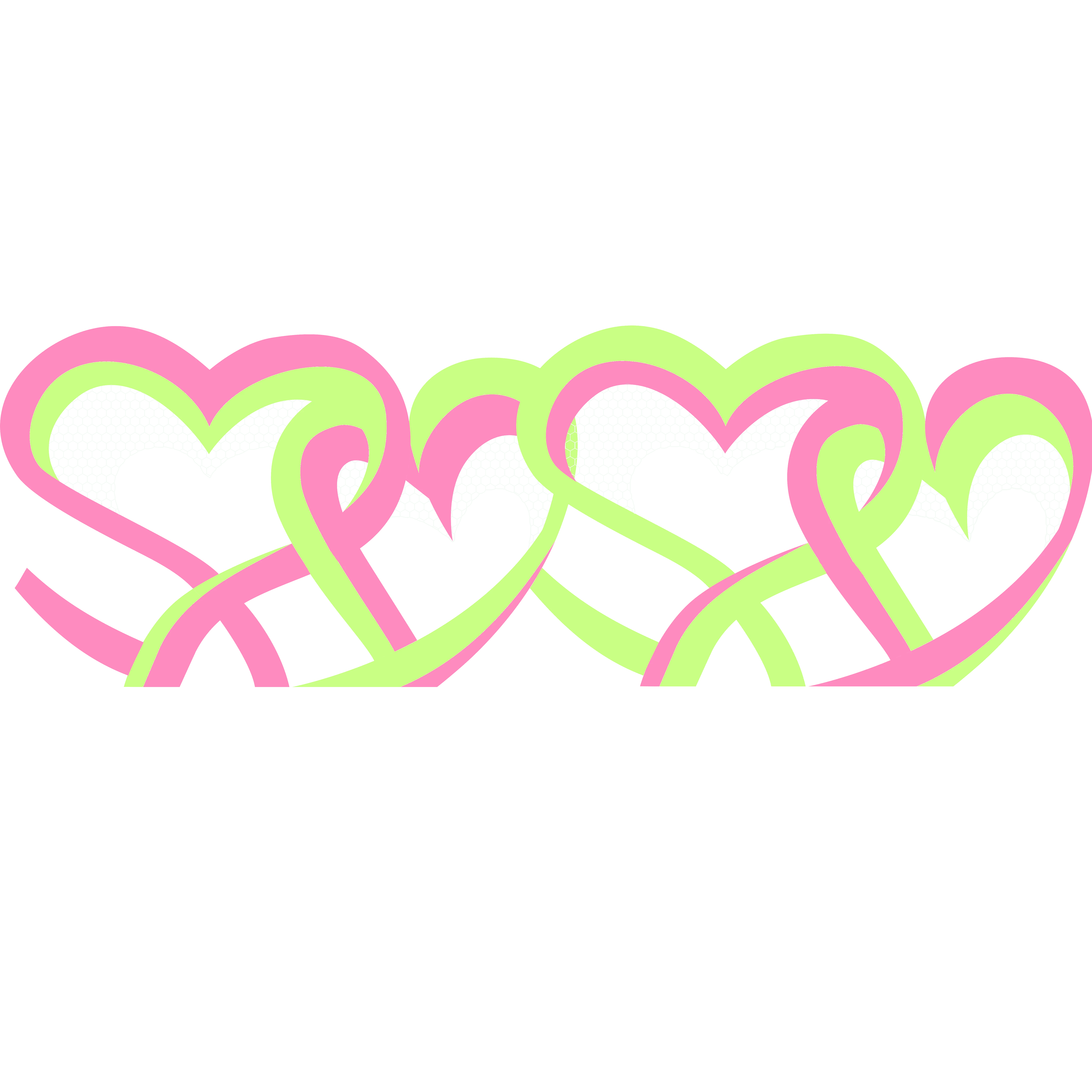

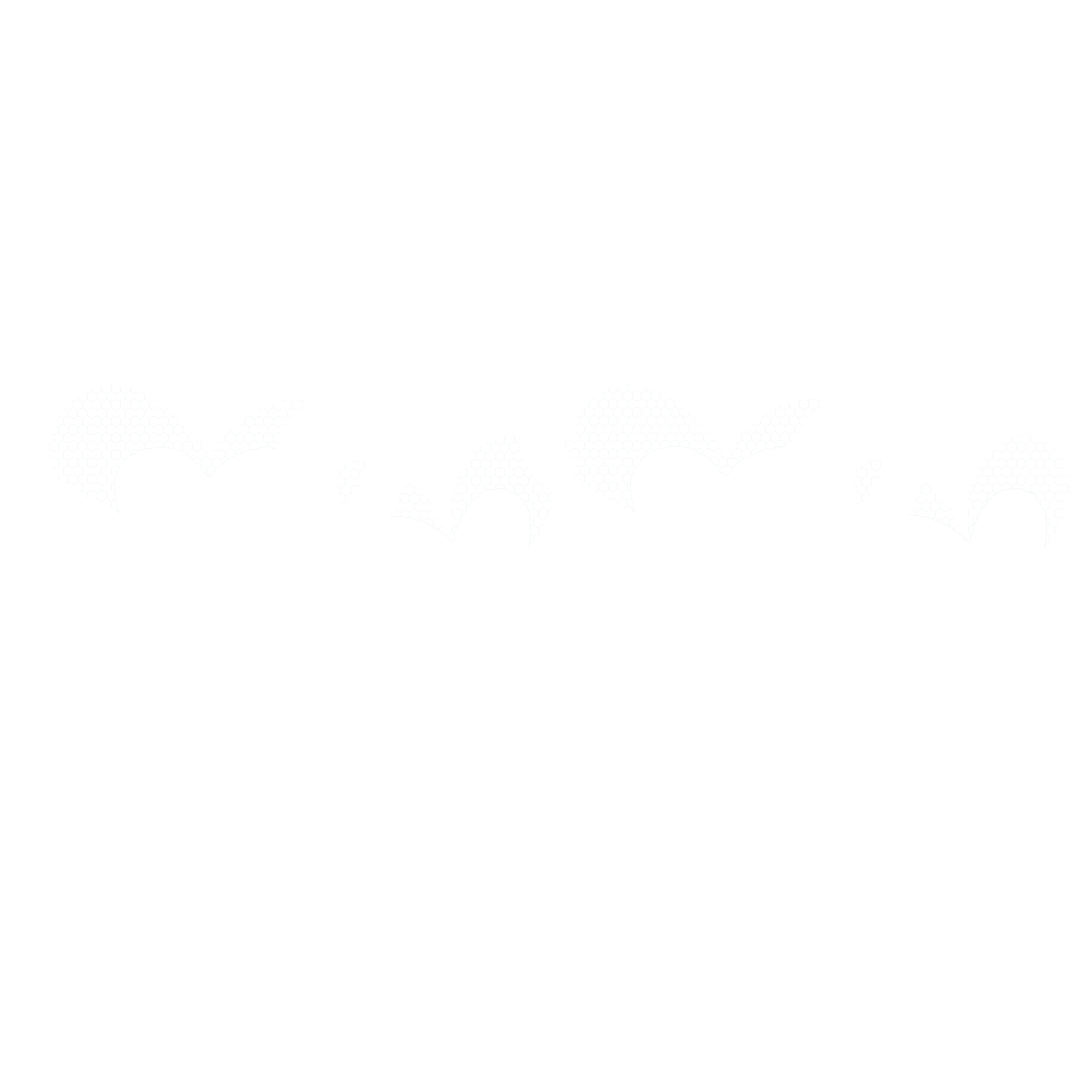

Sep 26, 2022 8:48 AM UTC
Hi
I thank you for your reply. Added a file with embroidery and a file with a grid

It looks like there is just too fine detail for those weaving/embrodery filters to be effective. You may need to split the material and use Sampler for the main threads and go to Designer to create a separate material for the finer lace threads. Designer can work in 8k (provided your PC will support it)
