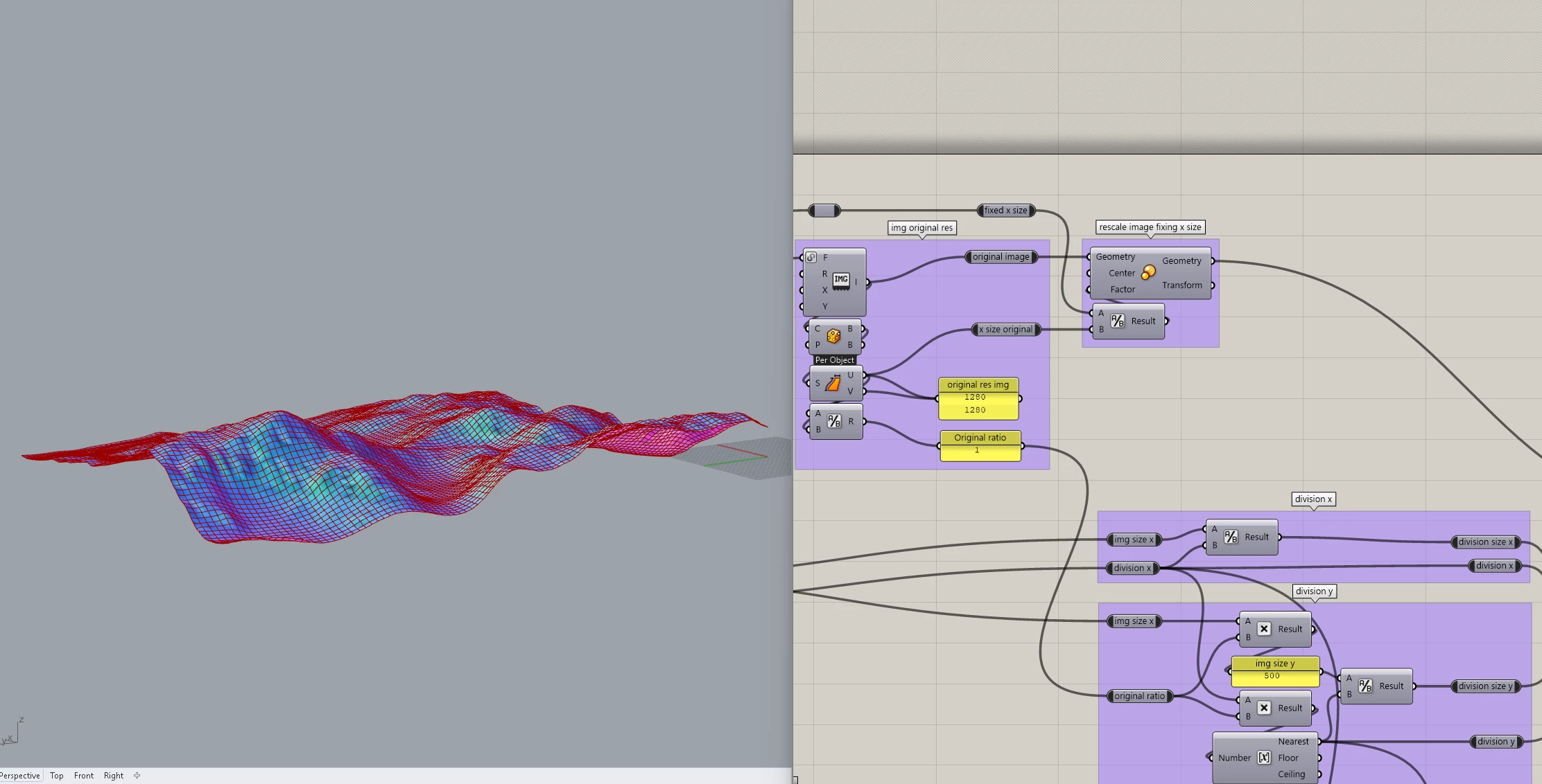

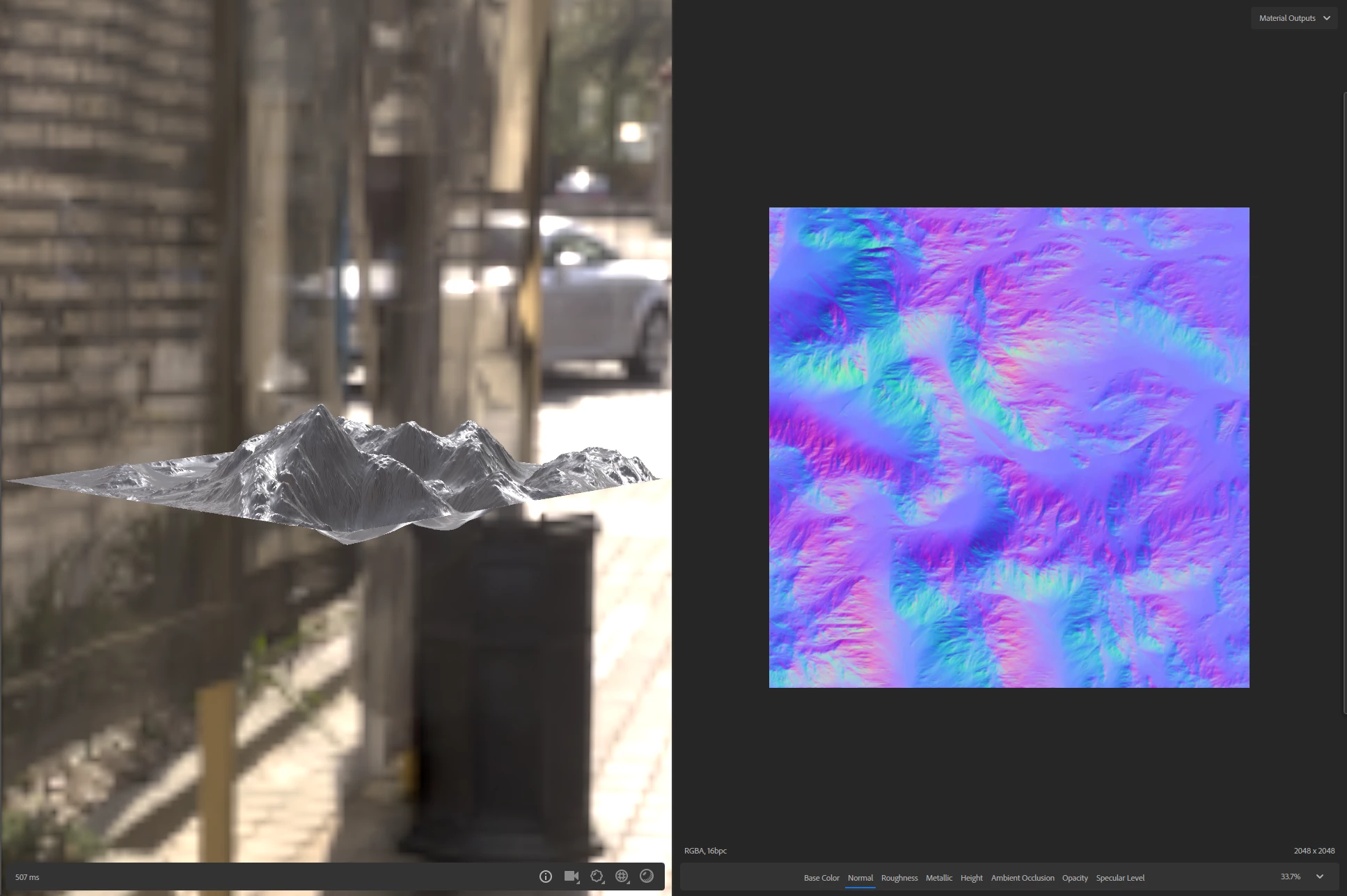

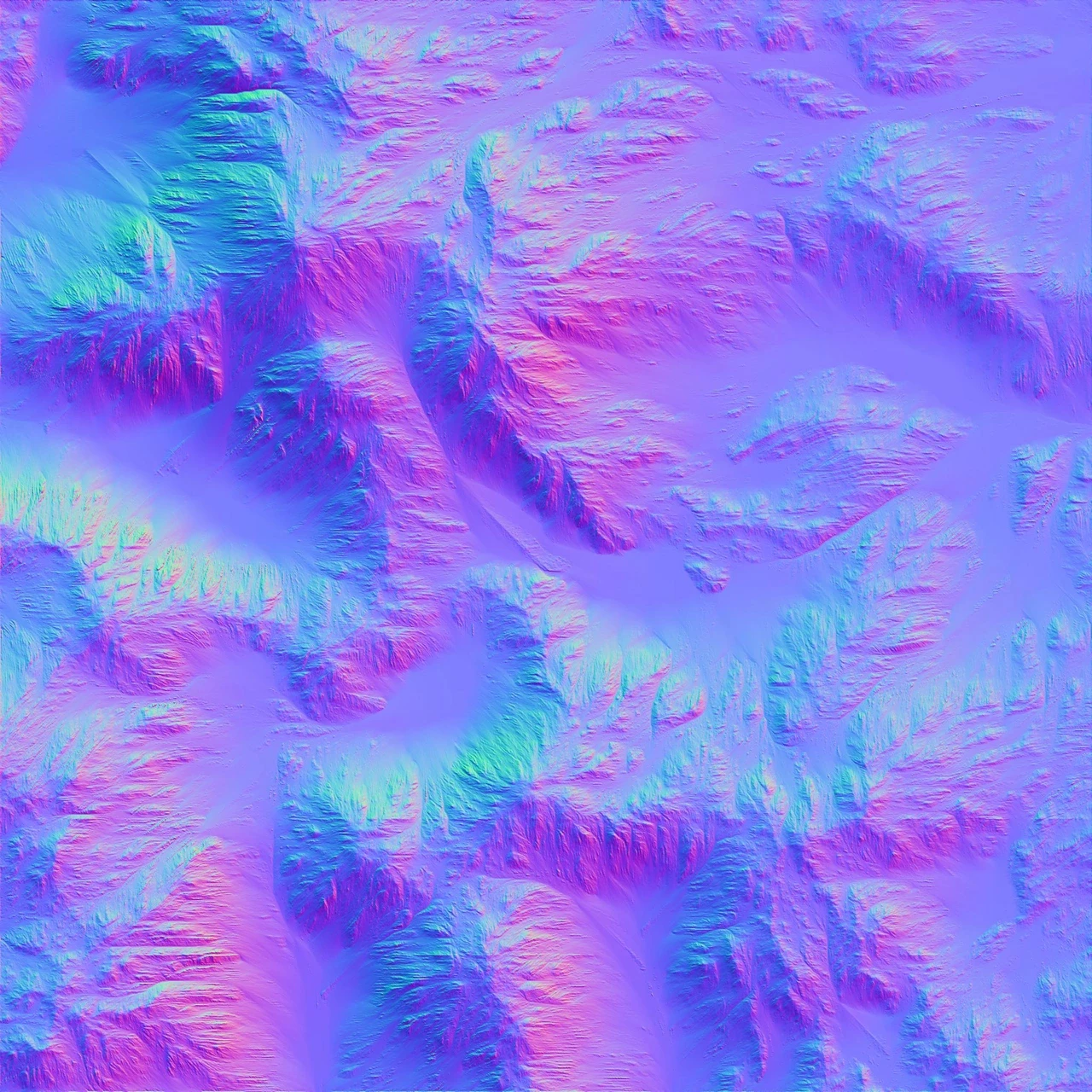

Sure: here are the normal map and two screenshots explaining the problem:
 normal map tested
expected shape calculated with a more robust error minimization algorithm
the shape produced by substance using the normal-to-height filter, locally gives a rather correct result, but the perimeters are completely flattened thus globally the more you get closer to the perimeter the more error you get
