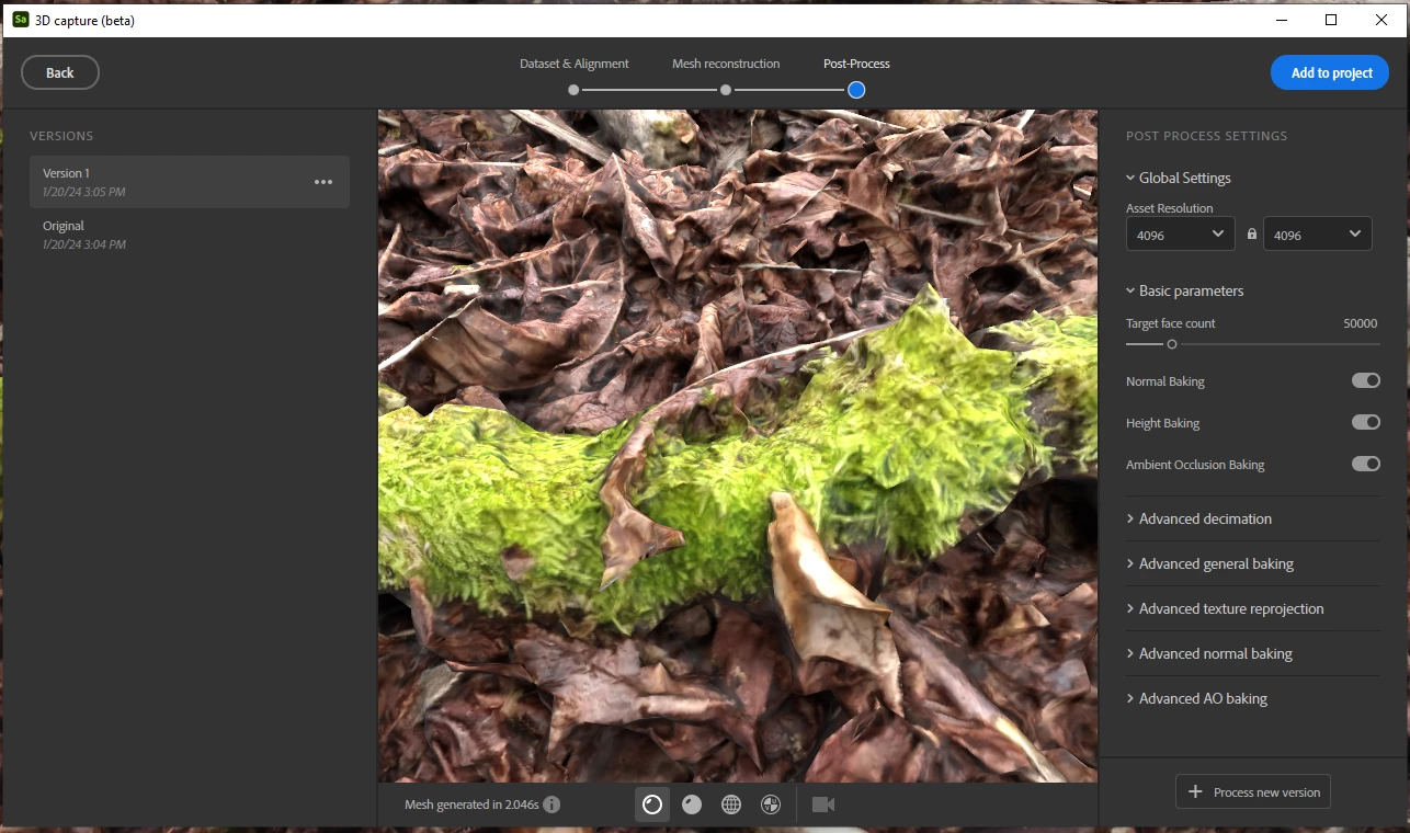

Hi everyone, just wondering if someone can help on some problems I have been having trying to use Sampler. I have posted quite a few on here but below are some of the problems.
1. During the post processing screen the program randomly closes. I have had task manager running in the background and sometimes my RAM usage was at nearly 100% and then the program closes, which I thought was the program, but the past few times it has closed my RAM was only about 47 - 50%.

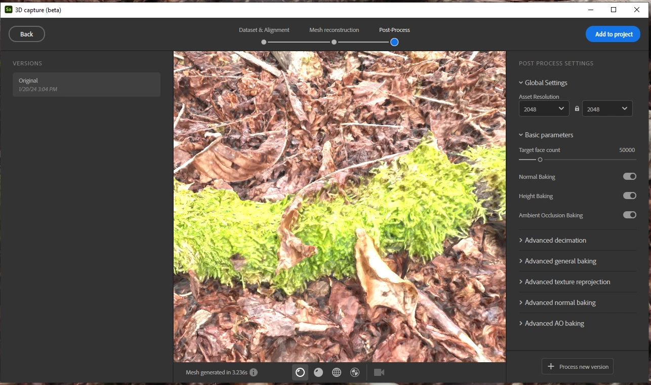

2. Recently when changing my asset resolution from 2048 x 2048 to 4096 x 4096 actually reduces my texture resolution (attached is a couple of screen shots).

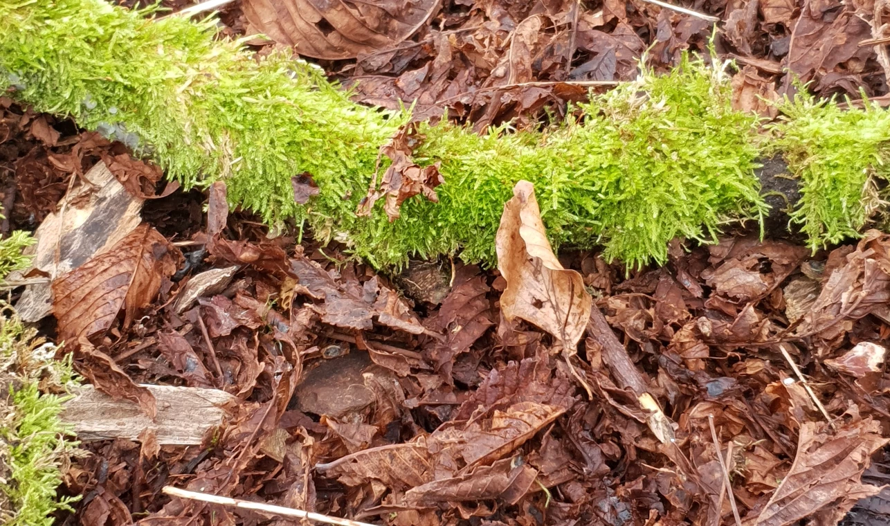

I have also attached a photo of the position when taking the picture and the resolution seems ok on the actual photo.
Is there a limit to how high the megapixel count can be on photos, as some photos were about 9MP on other files but these photos are 12MP (which is my phones maximum resolution). Could the photos be too large (file size) due to the higher res from 8MP before to 12MP now).

Hello @LeesVisuals,
I'd like to take a look at your dataset (the images), and make some tests on my end in order to answer you properly. You can send those at cdellenbach@adobe.com
For the size of your pictures, the dataset has to be smaller than 6G pixels (6 000 000 000 pixels) in total. It represents 500 photos of 12M pixels. However, there are no limitations with individual pictures, but I advise you to keep a certain consistency between images.
Cyril Dellenbach (Micro) | Product Manager | Substance Painter
