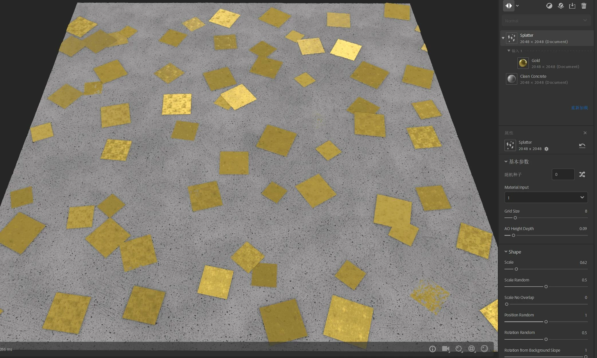

Splatter filter missing density adjustment option
Although this filter is rarely used, I have found that it cannot adjust the density of paper. Although the proportion can be adjusted, the basic quantity has not increased or decreased. Therefore, I think this filter needs to add an option to adjust the density of paper

Nov 29, 2023 6:49 AM UTC
@LoryAline   The meaning is to be able to control the density of quantity

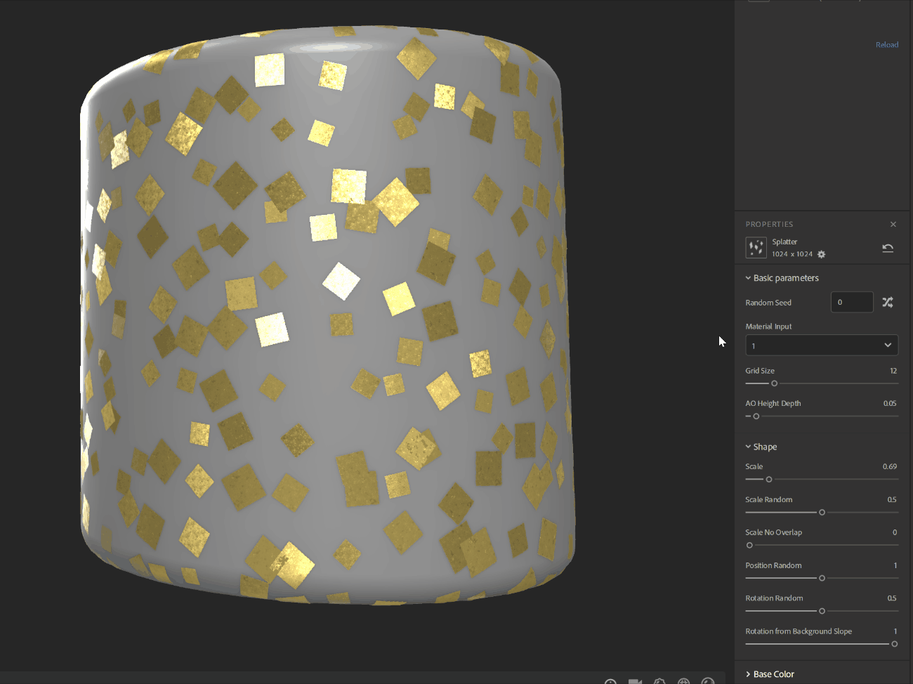

You can edit the Grid Size and the Scale, which is basically the density. Are you looking for something else?
Let us know.
