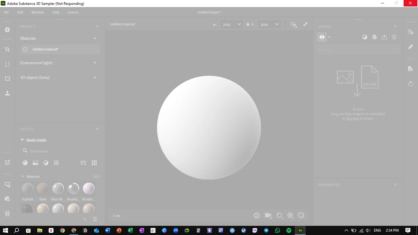

Substance 3D Sample NOT RESPONDING!
Hello everybody,
I am just having an issue with my Substance 3D Sampler. My app does not respond once I open it. Every time I open the app, it freezes and tells me "not responding" after just two seconds of opening. My device is not lagging at this time, just the app. This issue occurred with the latest version and when I tried to use a previous version, 4.1.1.
Thanks
Kyrillos

What Is your PC specs? Also are you able to open previous version?
Nov 4, 2024 7:48 PM UTC
Hi Ares,
Thanks for your response.
I can open the previous version, the latest too, but when it opens, it gives me just a few seconds and then it turns to a frozen status named after "not responding".
Regarding my PC here is the detailed spec info:
  1. Processor (1x 7th Generation Intel® Core™ i3-7020U Processor(Core i3-7020U)).
  2. Memory (1x 4GB DDR4 2133).
    3. Operating System (Windows 10 Home 64(EN:English,AR:Arabic)).
    4. Hard Drive (1x 1TB 5400).
5. Optical Drive (1x).
6. Ports (1x 4-in-1 SD-Card Reader (SDMMC SDHC SDXC); RJ-45; HDMI; Combo of 3.5mm Stereo Headphone Output; 1 USB 3.0(Type C); 2 USB 3.0; DC in).
7. Graphics (1x AMD Radeon 530, Intel® HD Graphics 620).
To note, the other Adobe Substance 3D products work fine except Sampler as I mentioned before.
Kind regards,
Kyrillos
