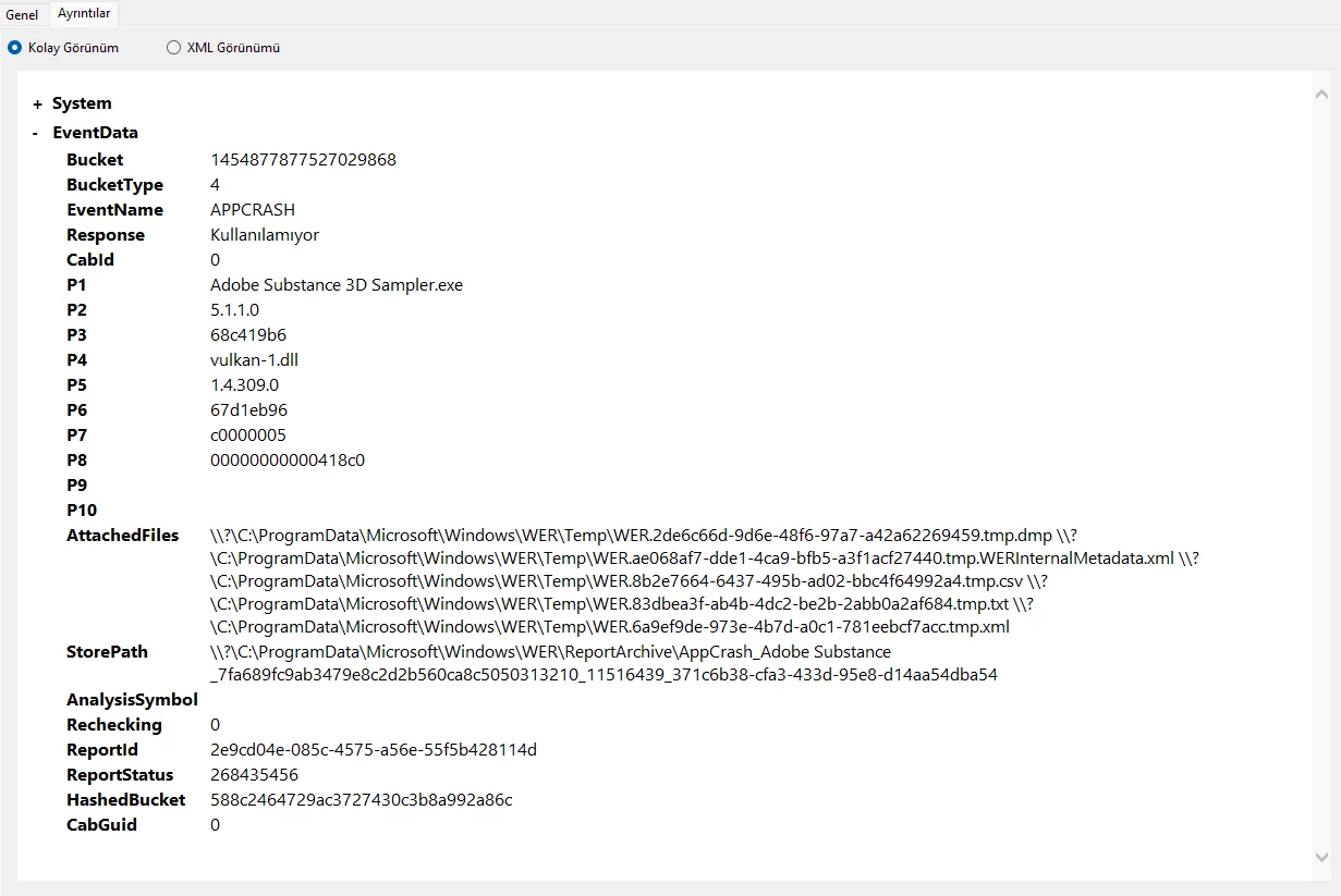

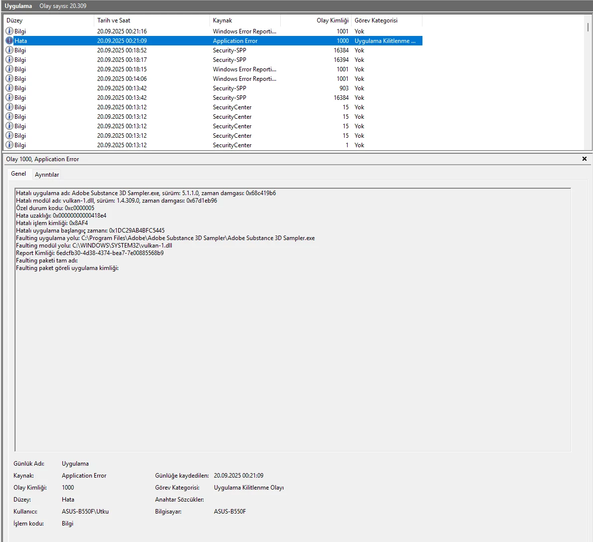

  • Event Viewer consistently shows errors related to vulkan-1.dll during the crash.

  • I have attached the Event Viewer logs (.evtx) that consistently show the Vulkan runtime failure.

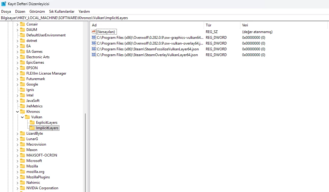

    Thank you very much for your help and effort. With the log file and assistance from ChatGPT, I was able to resolve the issue. The FPS Monitor application in my Steam library was assigning a value to the Vulkan location in the Registry. After deleting that entry, the problem was fixed. Thank you again, and I wish you all the best in your work.
    Bilgisayar\HKEY_LOCAL_MACHINE\SOFTWARE\Khronos\Vulkan\ImplicitLayers

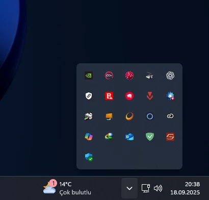

    • Are you using OBS Studio?
    • What kind of screen recording software are installed?
    • What kind of software with screen overlay are you using?
    This is very important to diagnose this first.
    On my side I can continue to try to help you, but the issue is not related to Substance Sampler, another app is hooking your Vulkan lib.
