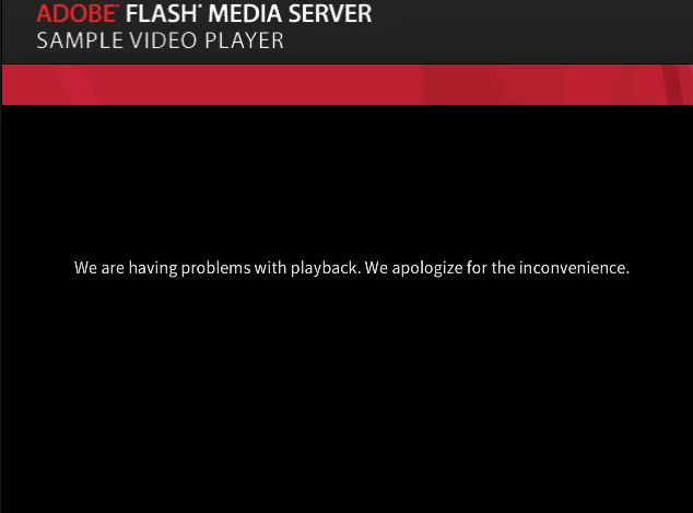

HDS streaming is not working, error: problem with playback
We have a problem to do HDS streaming in my FMS ...attached the screenshot showing error when i tried in my sample video player.
Normally what could be the reason for it. RTMP is working without any probelms.
Please advice where I can check the errorlogs for this issue.

i am also getting this error with Chrome, yet Firefox will play the streams/files without the error.

In both Chrome and Firefox showing same error for me ..

Petro_O__Bochan
Feb 2, 2014 2:39 PM UTC
That error is too generic. Provide details like FMS version, liveplgr xmls, httpd config files, etc.
b-castAuthor
Feb 2, 2014 2:57 PM UTC
FMS version 4.5
# cat Event.xml
<Event>
  <EventID>liveevent</EventID>
  <Recording>
    <FragmentDuration>4000</FragmentDuration>
    <SegmentDuration>400000</SegmentDuration>
    <DiskManagementDuration>3</DiskManagementDuration>
  </Recording>
</Event>
# cat Manifest.xml
<manifest xmlns="http://ns.adobe.com/f4m/1.0">
  <media streamId="livestream" bitrate="350" />
</manifest>
httpd.conf

Petro_O__Bochan
Feb 2, 2014 5:08 PM UTC
provide your publishing and playback URLs.
P.S. This is a public forum as opposed to Adobe support. You don’t need to paste the whole config.
