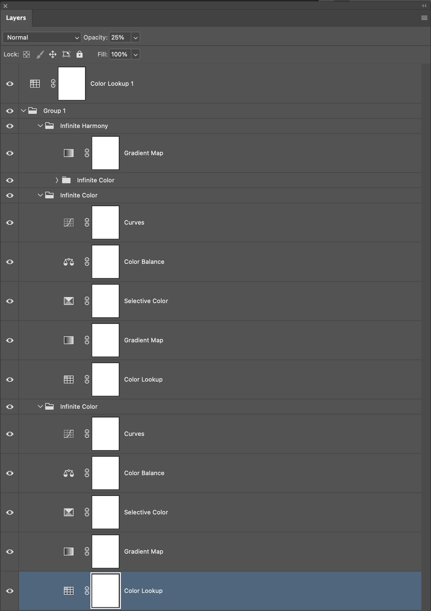

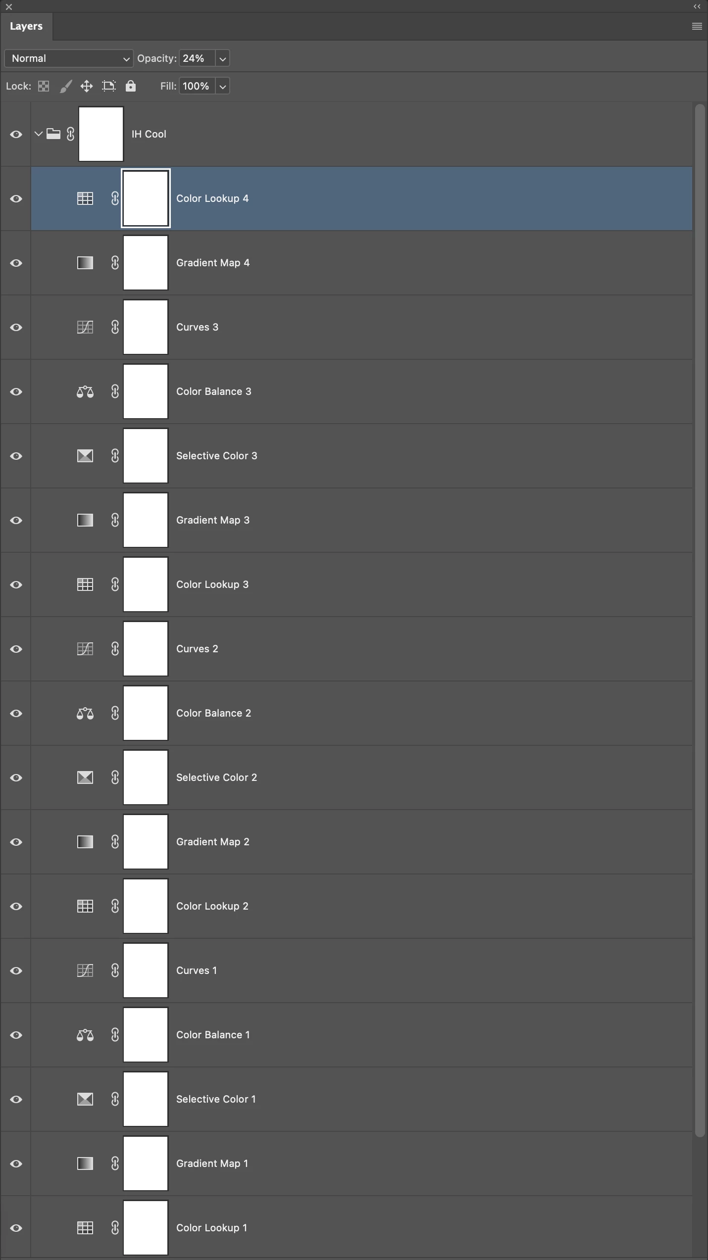

At this time, when creating a new Adjustments preset, the selected layers are filtered for adjustment layers.  If any groups are selected, then the contained layers will be filtered as well.  As you have discovered, any group structures will not be included in the preset.  If, for example, blend modes set on those groups were integral to the effect, the preset will not match.
If there is another aspect to your structure that is missing in the preset, please detail it here so that it can be included in a feature request.

Sure... I exported the preset from "Adjustmets->Your Presets" here:
https://www.dropbox.com/scl/fo/2u3bqck3pqdwq31ay9is9/ABMGeCwzU45yFHj3AYoiH9U?rlkey=sbqq2ztxp6lwhcmp1k4zx6kbq&dl=0
I also exported the same preset from "Libraries->Presets" I've never exported those before so I'm not sure if your getting the same thing...
But if you look at these screenshots, one of them is of all the layers as they are supposed to be.  The other is how the layers look when I apply the preset to an image.  You can see they are not the same.
