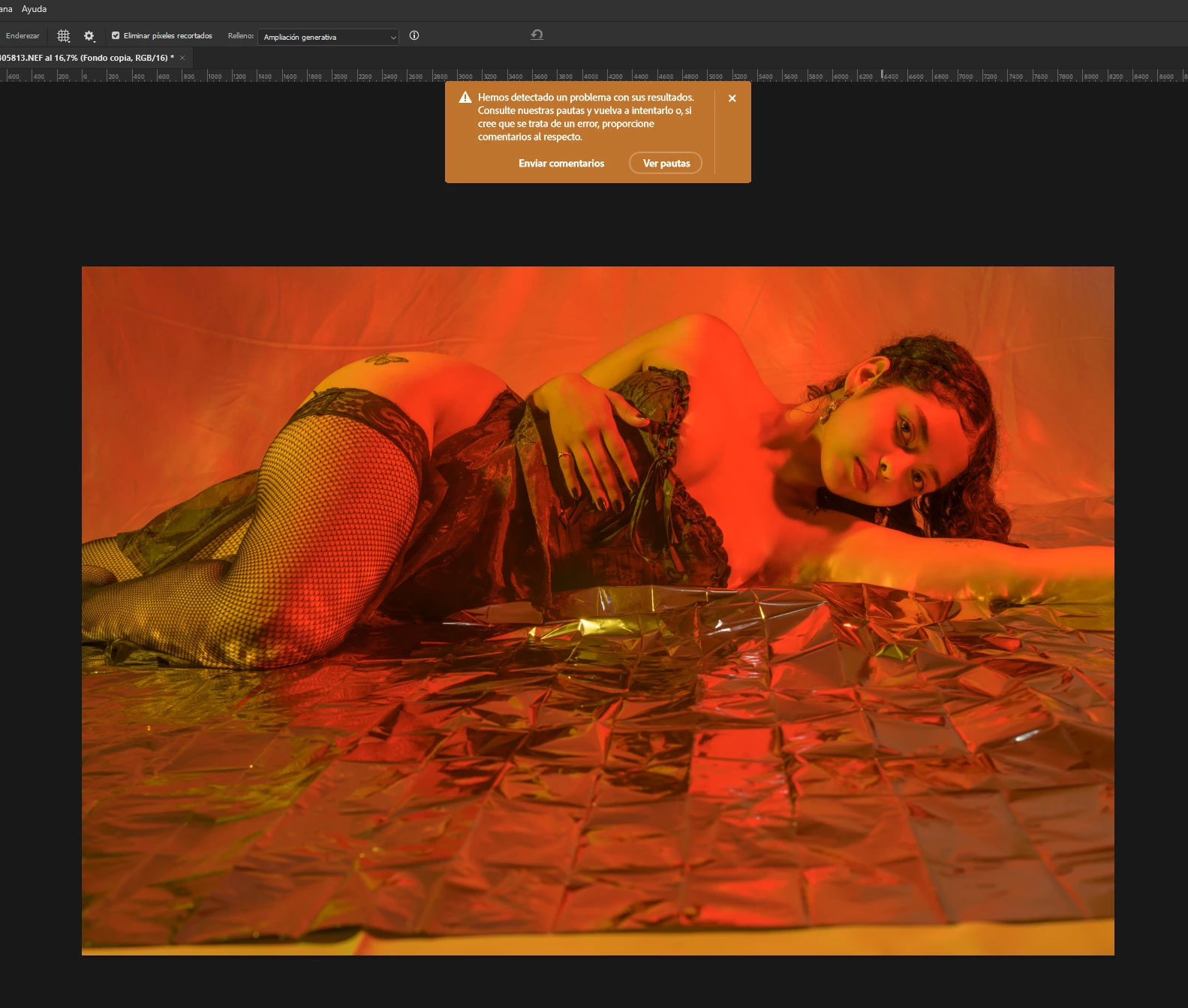

El relleno Generativo en la version 25.10 es practicamente imposible trabajarlo, creo que esta demasiado sensible. Alguna solucion?

claro que si, aporto dos fotografias una la original y la otra con el mensaje de error.

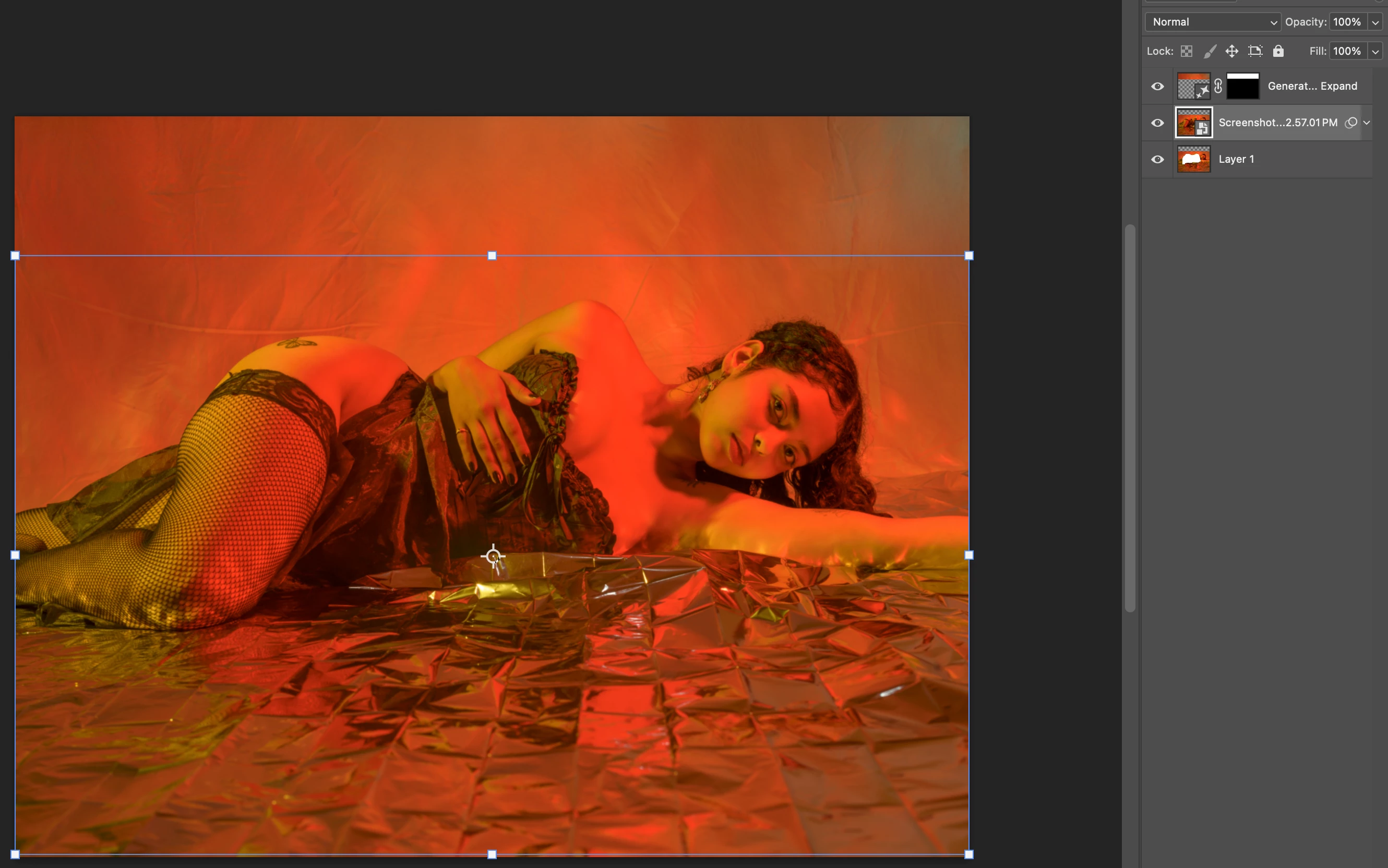

If you havent you should report this via the feedback pop up.
There is a way around "perceived" nudity - duplicate the layer, then mask out/cover up the offending area and generate.
Once generation is complete, turn back on the original layer to restore the original image.
I ended up painting over most of the torso and upper leg.
