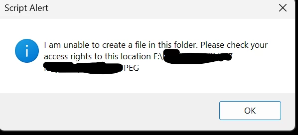

Error message: unable to create folder or file when Photo Processing from Bridge (PS b 25.12 m2735)
I select multiple photos in Bridge then select Photo Processor.
With the latest photoshop beta (25.12 m2735), I sometimes get error : "unable to create the folder / or file" when it is writing the file on disk.
With regular PHotoshop and previous photoshop beta versions, I never get that kind of error.
PS : it is quite random, not reproducible everytime ... but It occurend quite often ...

But the problem with the inability to write to the folder is not limited to this particular action. Even if I don't select any action while processing, the error appears randomly. Mostly on the 5th file, there is an error. If I lauch Beta as admin, sometimes it's not the 5th but a little bit later, but in most case, still the 5th. Error still occurs later, but it begins at the 5th.
And the number of failling fails are different everytime.

I don't see a similar error on my end when testing this workflow. The message you see indicates an access rights (permissions) issue. This could be caused by something going on with the specific files themselves, something about the drive they are on, or some form of interference.
Assuming that the error does not come up for the same files every time, then the files are probably not the issue.
What can you tell us about the F: drive? Internal/External? How is it connected? There could be issues with continuous communication.
What I think is more likely though, if this behavior seems somewhat random, is that there is external interference. This would come from some other application running on the system, perhaps hidden in the background. For example, it could be something like anti-virus locking files as it scans them. There are a lot of posibilities, so it would be helpful to test in a simplified startup, such as following the directions here: https://helpx.adobe.com/x-productkb/global/disable-startup-items-services-windows.html

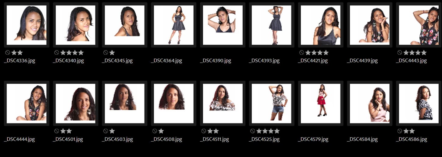

As for the results, I tested the action you provided in the beta version (25.12) as well as release (25.11) and see the same results in each. Looking at the details in the action, those results are what I would expect. The two things of note in the action's crop settings: "Left: -504" and "Bottom: 4032".
Having a negative number here means that it will move the left edge of the canvas to the left and (when using default settings) fill it with white (or whatever your Background swatch is set to). This would create a white bar on the left of most images unless it was a multi-layer document and one or more of thoese layers has content which is to the left of the current canvas edge.
With Bottom being set to 4032 (and Top is at 0), it means your canvas size will be changed to 4032. If the images you are processing are taller than this, they will get cropped to this value. If they are shorter than this, you will get a similar white bar as described above, at the bottom of the image.
When I run the action, that's what I get: white bars on the bottom and left (which seems to match the results you are seeing in your screen shot from 25.12).
Since you are seeing different results between versions, one of two things are happening: 1. you are working with differently sized files 2. the settings for the crop step in the action are different. If you created the action from scratch in each version, it is quite possible that there are different settings in each version. Have you tried loading the copy of the action you sent us in each version of Photoshop and tried running it? My guess is if you did so, you would see the same results from each version. Also, if you check the crop step in the action of each version, you will likely see different numbers.

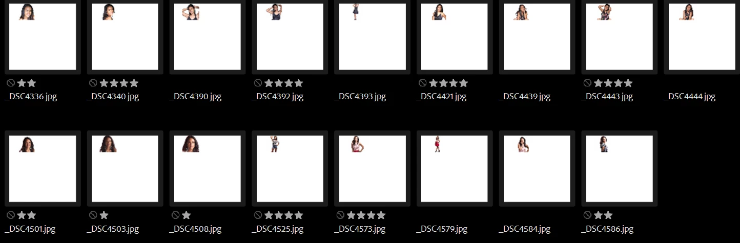

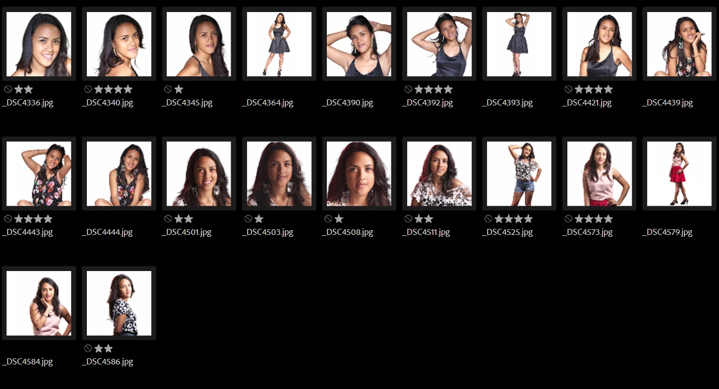

I would like also to mention that the results of the image processing with the beta versions are different from the images produced by the non Beta version ! Very strange.

resuslts from the non beta are fine, below :
While the results from the beta 25.12 are not ok :
And If I am right, the result from beta 25.11 (not ok also) were :
Really strange. Using the same action.
Note : at the end of the processing, the beta version says also that it couldn't write the document preset ...

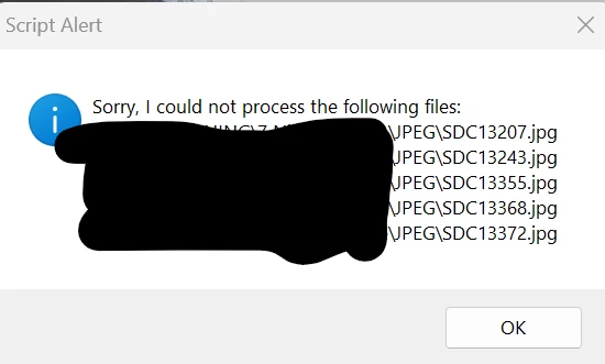

I just select 20 pictures from Bridge. Then choose Image Processor. For example, as output format JPEG, resize to 1024x1024, then RUN.
Then the error message appear.
Among the 20 files, it says 5 could not be processed
