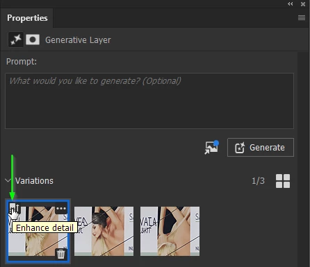

Hi Deven.  Where are you at right now with this?  The Firefly engine has quadrupelled resolution to 2048 x 2048.  You can move the Styles > Visual Intensity  to the right for maximum detail.  There is also Enhance Detail that doubles the resolution of the generated content. (icon in the top left corner of each variation in the Properties Panel.

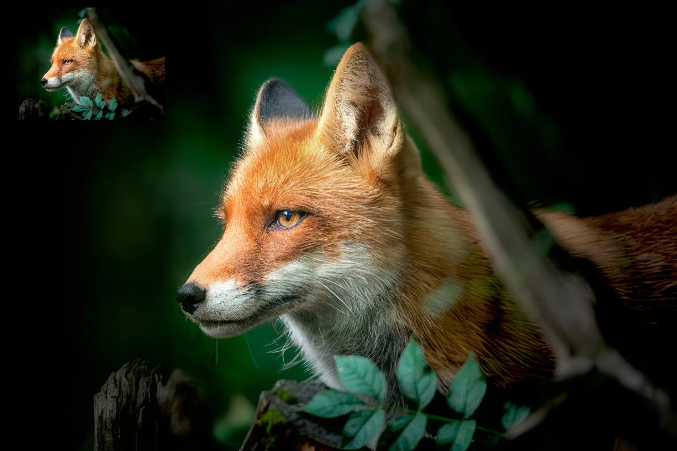

Outside of this there some amazing Ai upscaling tools now.  I use Topaz Photo Ai that does an amazing job, but is a little bit expensive.  I just tried it on a random stock image, and this is what a 4X upscale looks like.  (click to view full screen)

You need to look at Topaz Photo Ai.  I was put onto it by Lisa Carney, who works for the Hollywood TV and movie industry making artwork with Jesus Rameriz (The Photoshop Training Channel).  They work at the resolution allowed by the Firefly engine, and then upscale up to 6X with Photo Ai.  If you start with a good quality original then the upscaled image will be equally good, or even better because of how good its denoise and sharpening are.  It would be fair to say that these two people changed how I work with Photoshop and content creation.
