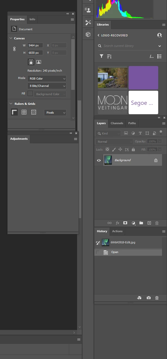

In last 2 versions of PS Beta (current 25.2.0) the adjustment panel is not working
  • October 19, 2023
  • 12 replies
  • 3021 views
In the last two updates of PS 2024 (25.2.0 on WIN 11 OS) the adjustment panel shows up but the are no icons and if I go to the upper right corner and choose adjustment (levels for example) I get "Could not complete the command due to program error"
This is very inconveinient, I can dublicate the layer, go to menu "image>adjustment>levels" do my business and then add a layer mask but that is not how we want this work, right?

This together with a similar issue with missing Toolbar icons has been going on for a while now.  Most of the posts were about missing Toolbar icons, but I had the same as you...  not Adjustment layer icons.  The thing is, I thought this was fixed a couple of updates ago.  What is worse in your case, is getting the program error message when trying to access the layers via the right click drop down.  I can't think of any other thread  reporting that.
Can you access them via the Layers menu?
In the full release verson I have the Image > Adjustment shortcuts transfered to Leyer > Adjustment Layer and that's how I was adding Adjustment Layers when I had no icons.  So can you tell us if you can add adjustment layers from the menu without getting the Program Error ?

Menu>Layer>Adjustment layer works, no error

I'm currently on PS 25.2. Since yesterday, I'm experiencing the same issue, i.e. Adjustments Panel = blank.
If I want to switch from "Modern view" to "Classic view", I get "Could not complete the command because of a program error".
I have tried "resetting the preferences", still doesn't work. I had installed 25.2 a while ago and everything was working fine until now. I have also tried "Older GPU mode" = no luck.
I have installed PS 25.4 (beta), on this version the Adjusment Panel is normal and works fine.
