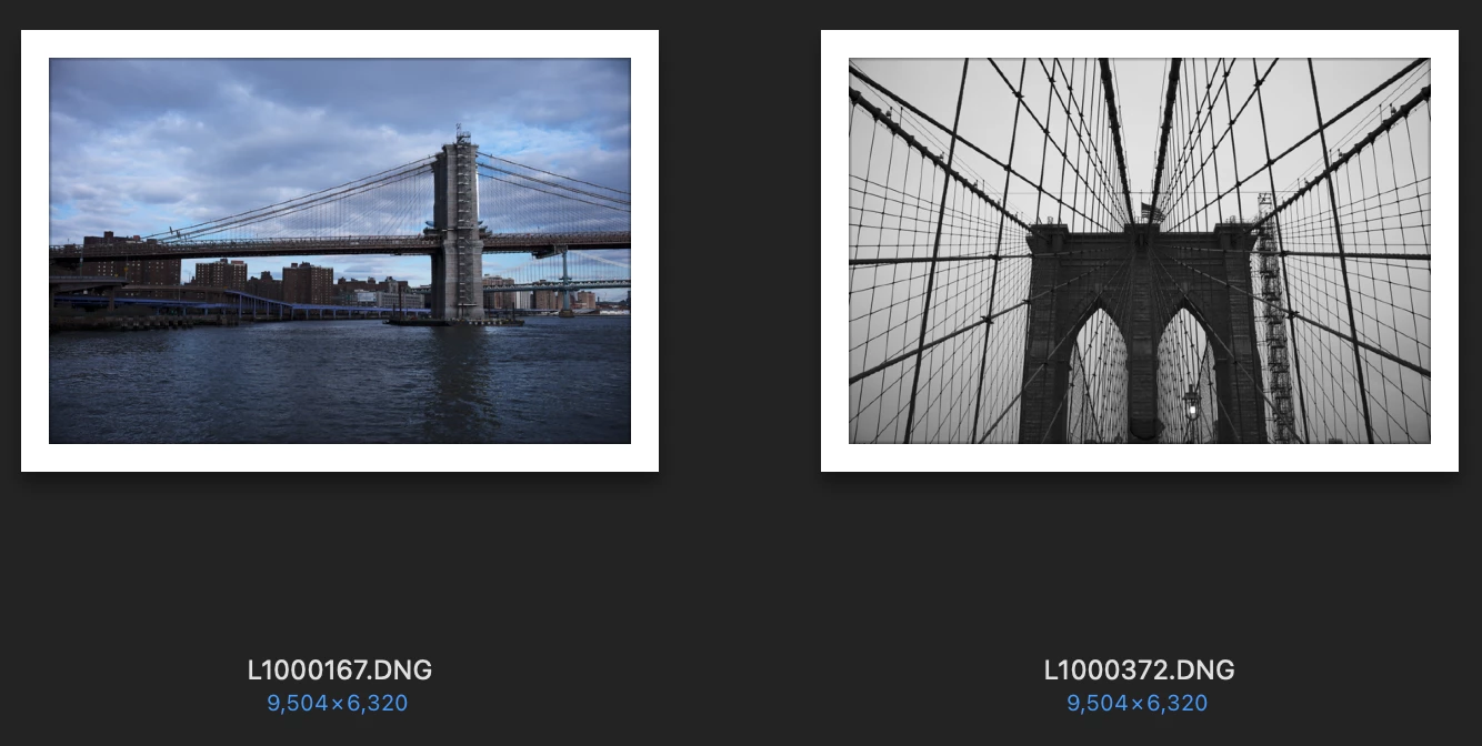

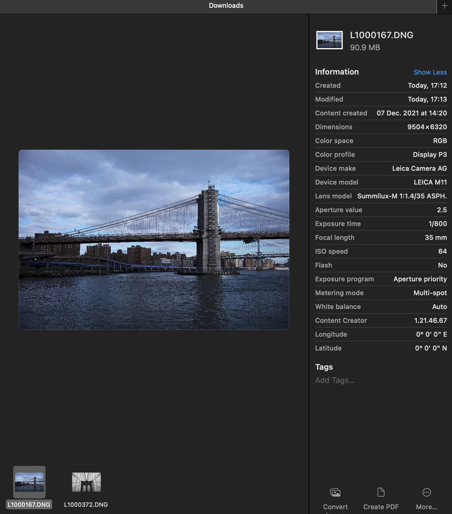

The reason why it takes an unusually long time to display a preview of Leica M11 DNG files in column view is a macOS issue.
In Finder, previews are displayed immediately in icon view or gallery view, but in column view they take an unusually long time or don't appear at all.
Icon view
Gallery view
Column view
Similarly, Photoshop's Column view can take a few minutes to display or may not display at all.

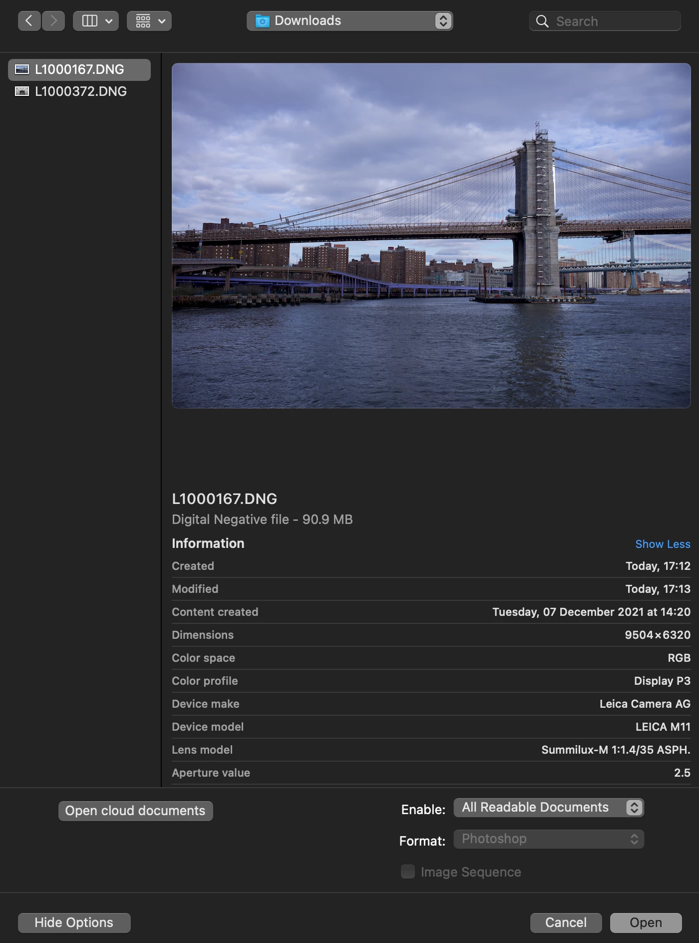

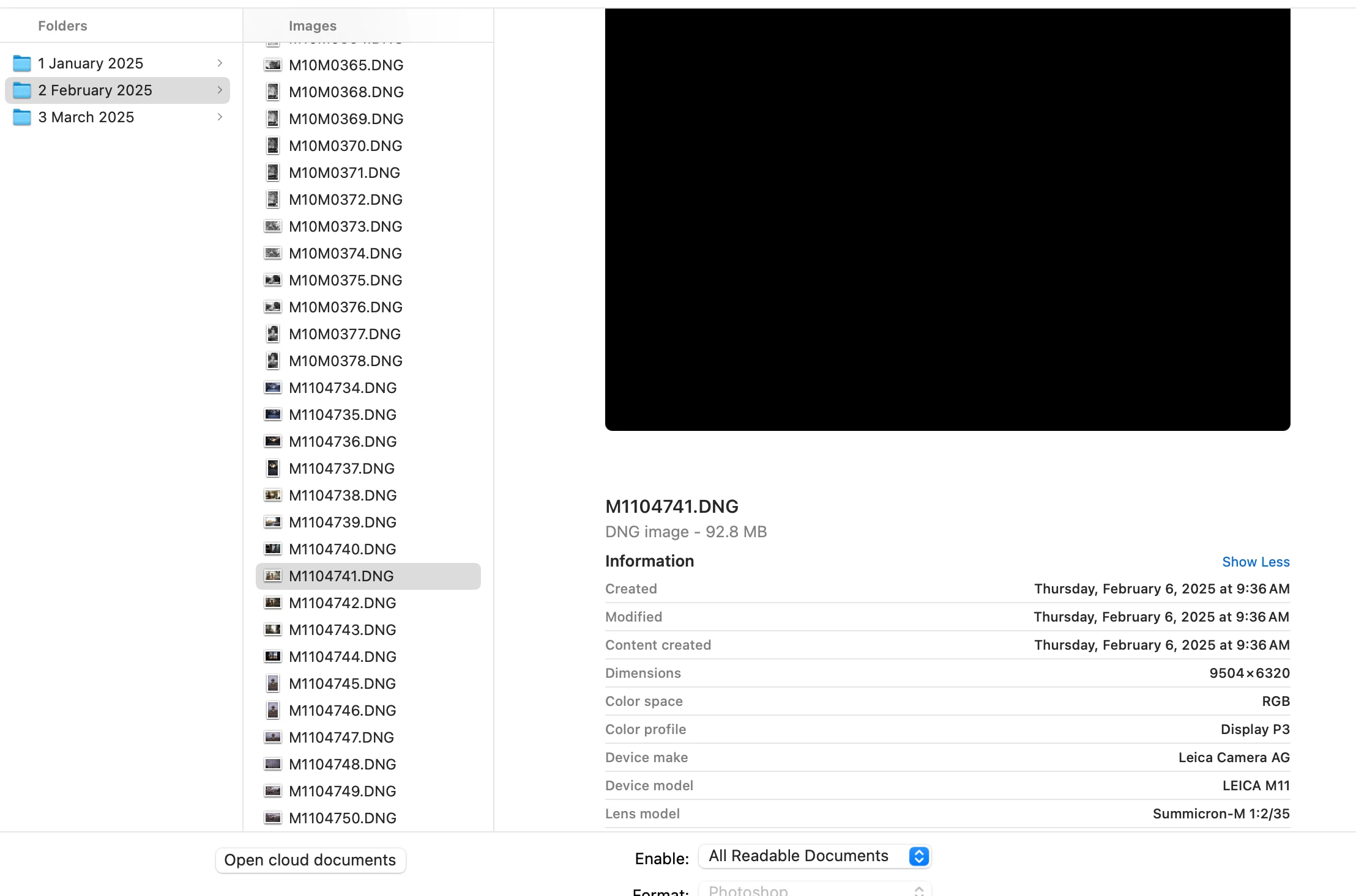

"To be clear, is your issue that when you OPEN a file from the M11 in Ps beta and Ps release, it shows as black, or are you saying that when in the finder and you click on a file, THAT preview is black?"
Cory, only when I click on the file in the Finder it previews as black. When I open the file in PS beta or PS release the DNG does import in the programs ok where it appears. If I use Bridge, it will appear as normal. Someone sent me a Leica M11 DNG file and it acted the same. BTW I do have the latest Camera Raw v.17.2

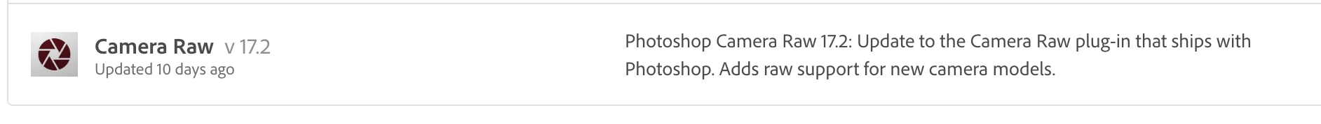

@louiedi2 Thank you for your sysinfo.  Do you have the latest Adobe Camera RAW v.17.2? Your camera is supported.
To be clear, is your issue that when you OPEN a file from the M11 in Ps beta and Ps release, it shows as black, or are you saying that when in the finder and you click on a file, THAT preview is black?  Trying to see what is Mac OS related and what is Ps?
