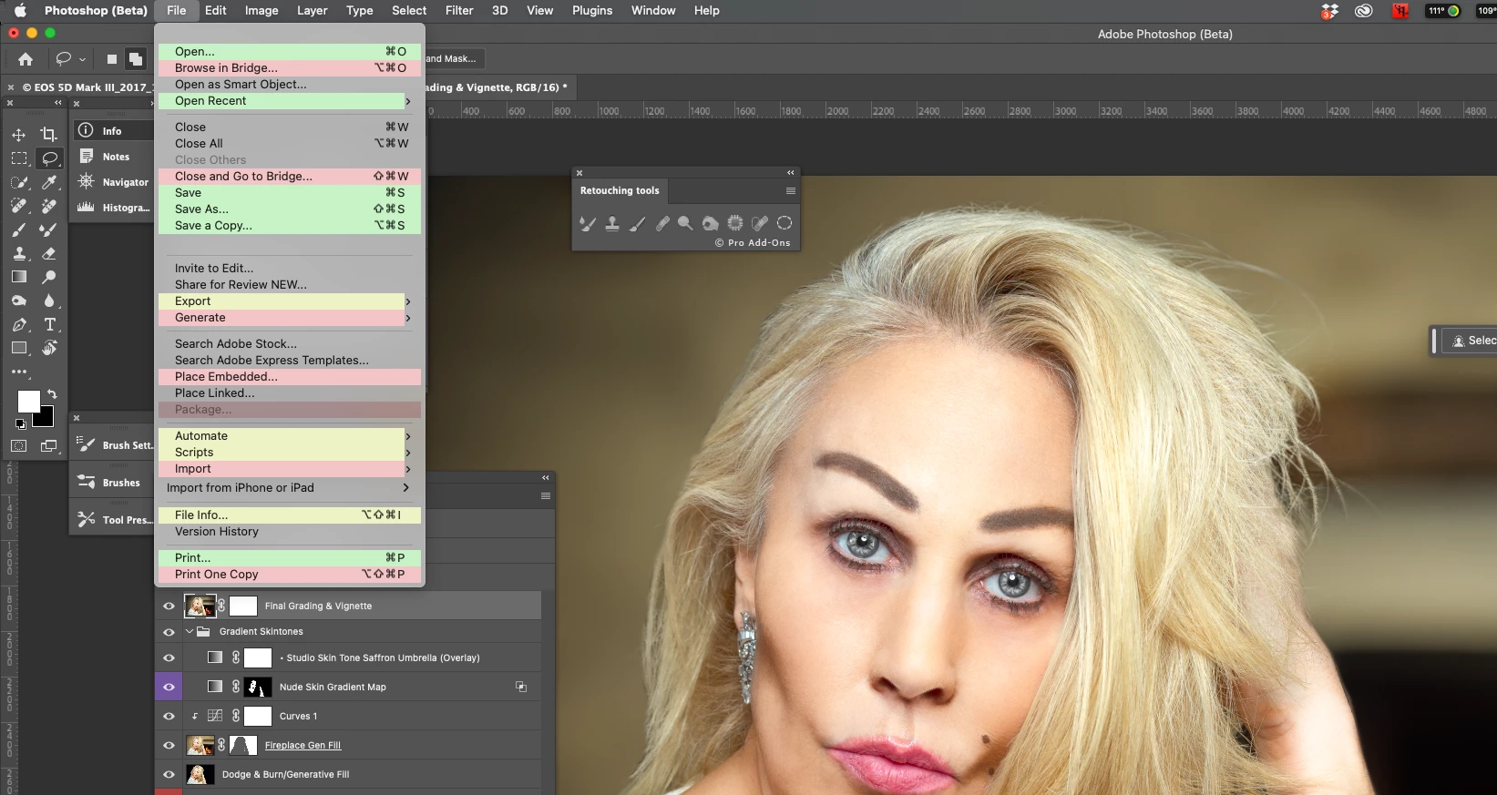

Aug 31, 2023 1:06 PM UTC
New bug (for me anyway) in Beta 25.1
Please download the attached file to view this post

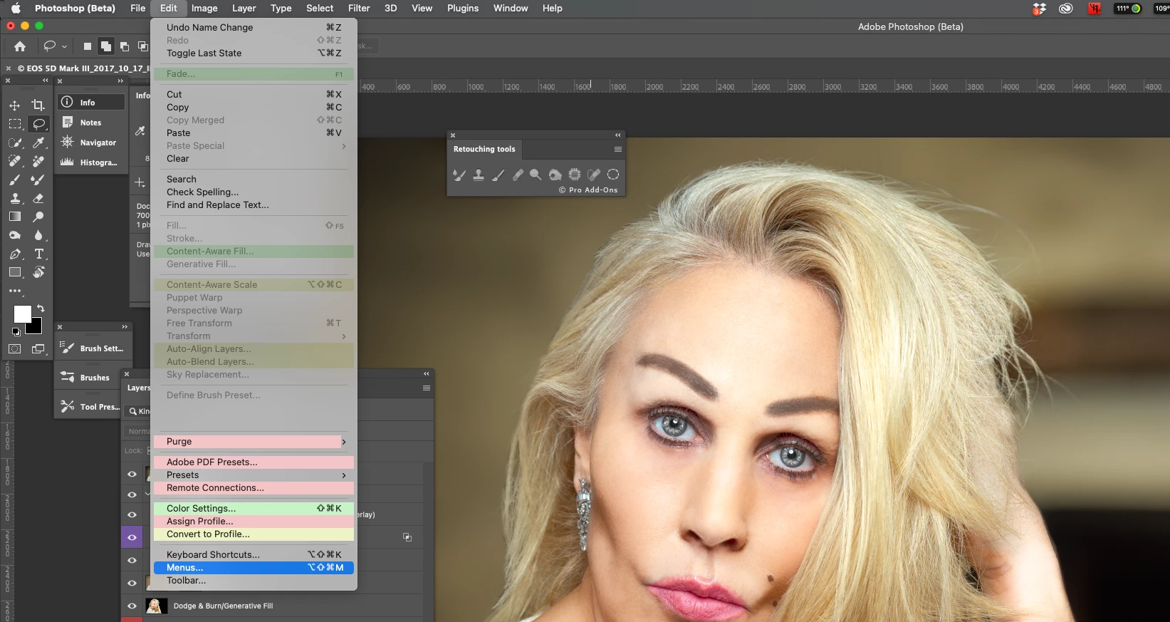

Hi!
I think AI found a simple fix - Go to Edit --> Preferences --> Interface and uncheck "Show menu colors".  I tried the longer method below and it also workd but this can be done inside Photoshop.   I hope this helps

3HoundsAuthor
Sep 1, 2023 4:50 PM UTC
Thanks, that did it. I figured there was an issue with the colors. I could turn some off, but others always reverted back.
I was using the default menus, but now I can make this change and use my .mnu file with trimmed down menus.

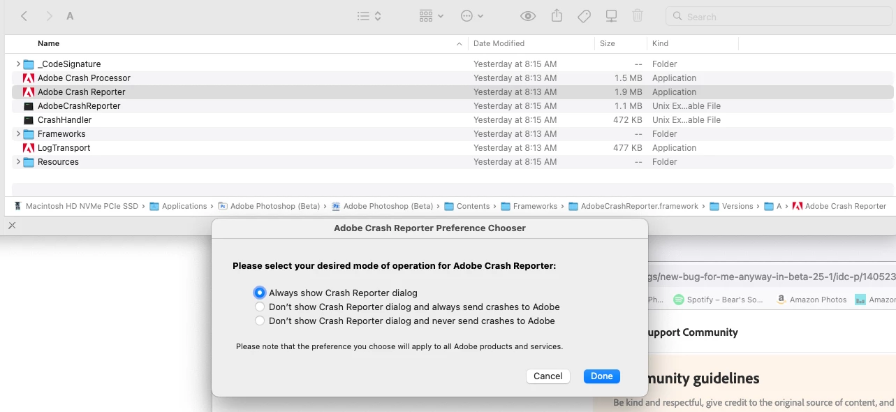

All my contact info is with that email. As I just replied... PS didn't give a crash report, apple did, that's what I pasted in my 1st post. How else can I get you the info?

Photoshop did not submit the crash report, the report was Apple generated. I checked the Adobe Crash Reporter app and it is configured as required. How else can I send the report that I do have?

Aug 31, 2023 3:53 PM UTC
Hi Caity, here you go... After I get "Menus" I can select "Revert" and PS crashes. Thanks

Hello! Can you share screenshots of the missing items?
