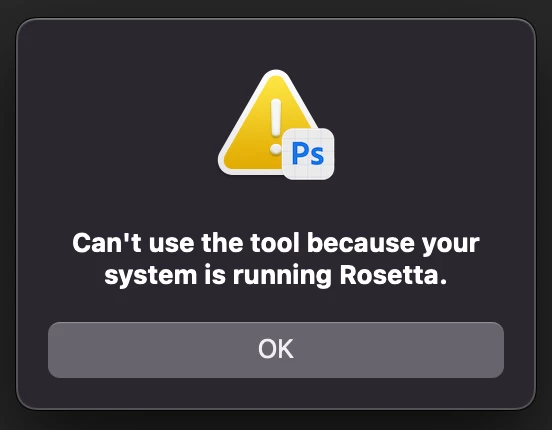

@Debra Boucher, from the team.
"If the system is running Rosetta on ARM-based Macs, we will disallow customers from using the Remove tool and pop up an alert saying "Can’t use the tool because your system is running Rosetta."
So we are afraid the remove tool is not planned to work with Rosetta.

Thanks for the report @SeanBPics !
I've been able to reproduce this and have logged a bug for the team to investigate what's going on here.
Here's the error when attempting to use the Remove tool with Rosetta:
