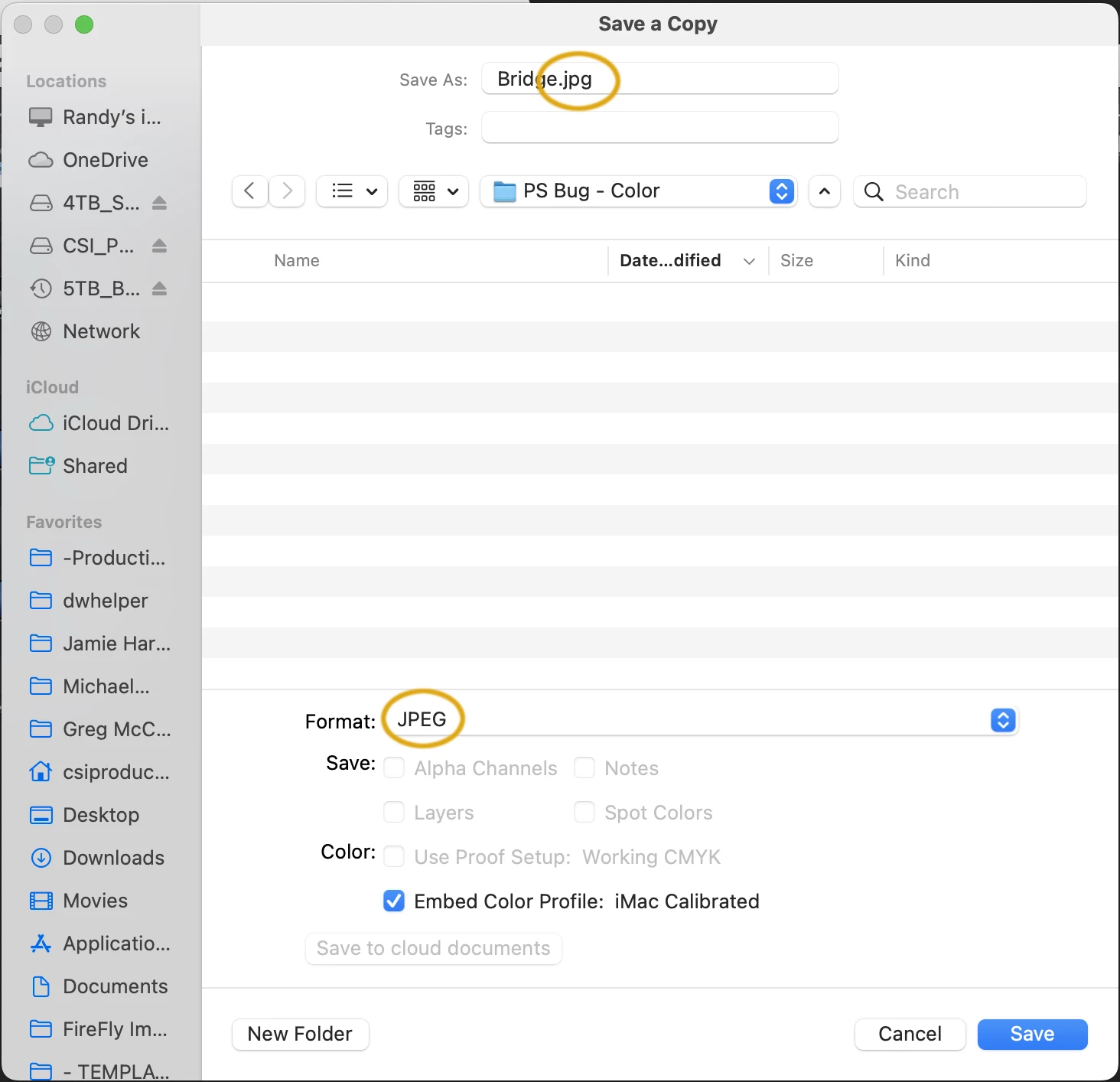

I'm working on a Pr project with graphics saved with the .jpeg extension. I'm opening graphics that need editing with the CMD-E command in Pr. They open in PS, I make the edit and use CMD/OPT-S to save as a .jpeg. The dialog (at the bottom) says .jpeg but up where you name the file it has a .jpg extension. If you miss this you've now got two files and one isn't saved with the extension you edited so it doesn't update back in Pr.
This drove me nuts until I realized I was saving two copies of the same graphic with with .jpg and the original I "thought" would be replaced once saved.

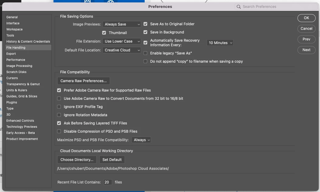

Hi @CSI Productions curious if you have this set in your prefs:
Have you tried ticking Enable legacy "Save As"?

That did it! Thanks Cory. Moved my Account Issue to a different string.
