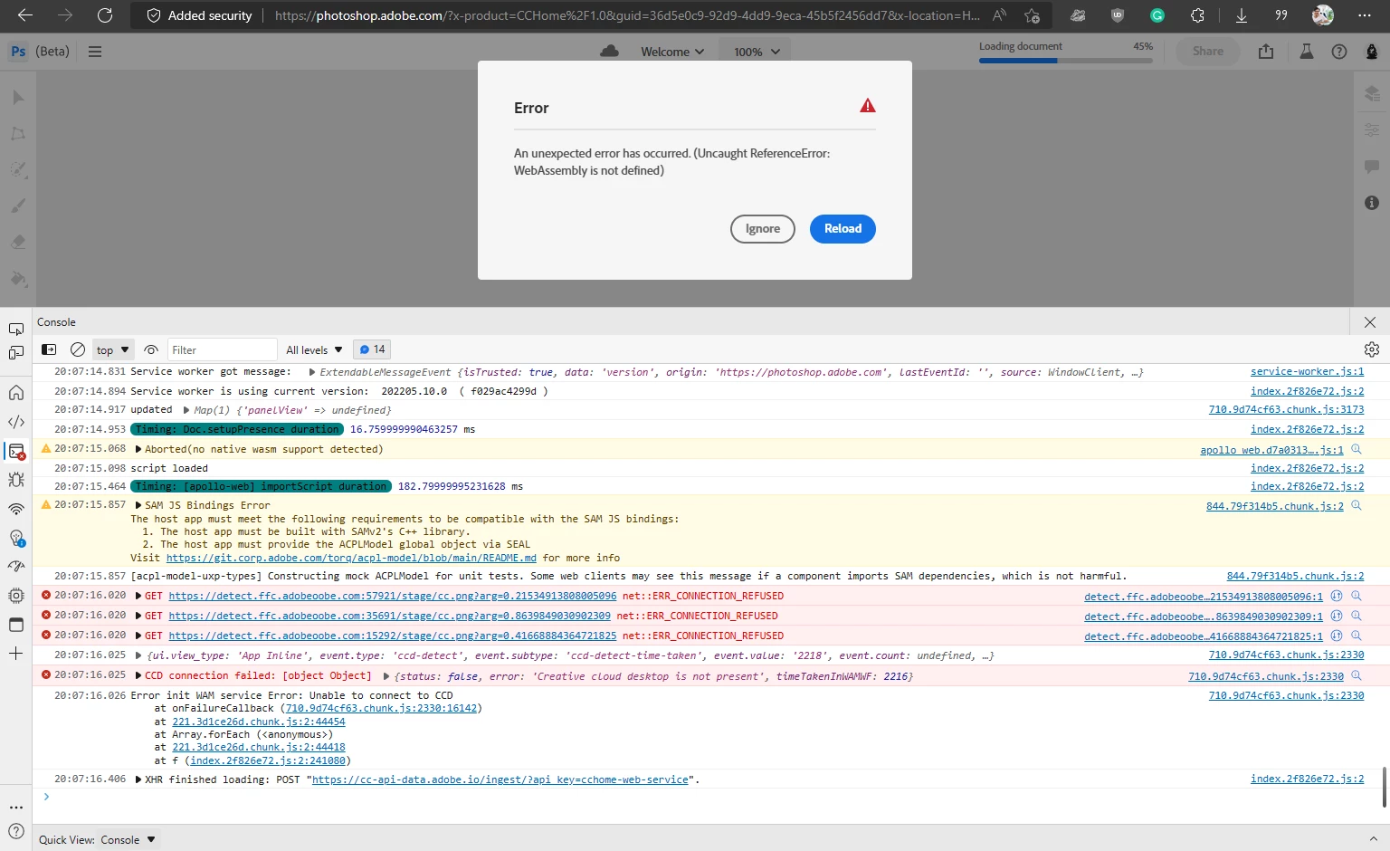

On launching Photoshop Beta, I am receiving a Reference Error stating that the module WebAssembly was not found. I am running the latest stable release of Microsoft Edge.

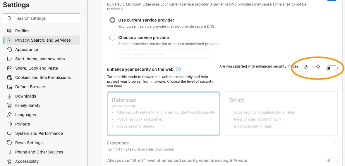

Hi @Saprativ, curious if you have this setting enabled?  If so, disable and see if that solves this issue. If this is the case but you want the flag turned on, you could add an exception for 'photoshop.adobe.com' right underneath.
Please let us know if this fixes the issue for you.

I did have the setting turned on. Added an exception for photoshop.adobe.com and it solved the error immediately! Thanks, Cory!

I have tried this only today (Jun 7) and have been receiving this error, even now, whenever I'm trying to open Photoshop Beta. I have tried this in the latest stable release of Chrome and there is no issue there.
I'm using Microsoft Edge version 102.0.1245.33 (Official Build) (64-bit)

Hey Cory,
Thank you for your reply. You can have a look at the console log file https://drive.google.com/file/d/1pi0_bBKI4J95LT4FQoQUcmKik6CurSUJ/view?usp=sharing. Below is the screenshot of what I'm seeing while trying to open Photoshop Beta in Edge:
I hope this is helpful for you and the team.
